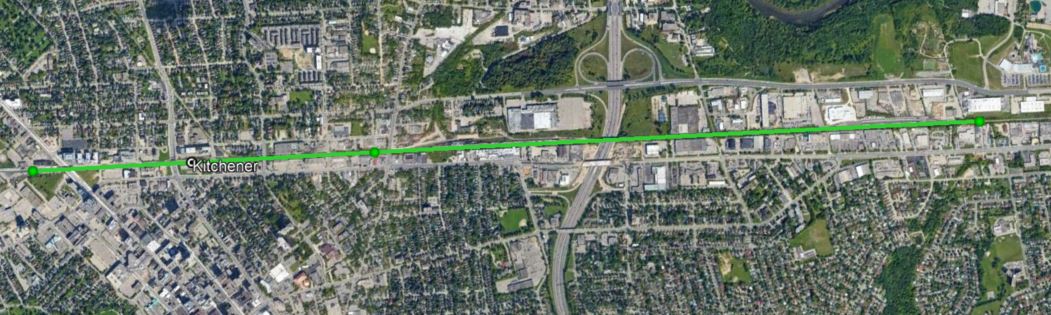

None of this is necessary. There's a crossover at Lancaster street east of the station, which GO already uses in order to access Shirley Yard, which is on the north side of the tracks. From that switch eastward to the end of double track is 2.8 km, which is enough to schedule a meet with relatively little delay.
Switch at Lancaster Street
Green segment is double-tracked, dots indicate switches.
But this discussion is moot anyway because they are building passing tracks in Guelph and Breslau as we speak, which are both better located than this one.
