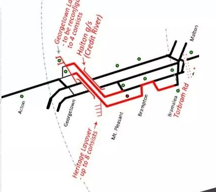

A Metrolinx presentation to the City of Brampton included this diagram suggesting that at build-out (4-8 years in the future) there would be 4 tracks - two over the grade separation for GO and two under the separation for CN. The Credit bridge is currently built for 3 tracks, with 2 installed.
Interesting, so the plan is to go over(not under as I assumed) the CN "only" tracks and to add an additional pier for a 4th track over the Credit. Pretty big job. That 3rd track through Brampton will go on the north side I assume?
The existing tracks drop from ~250m to ~246m west of WCB, which Metrolinx stated in their expropriation defense assists with elevating their tracks over the grade separation.
