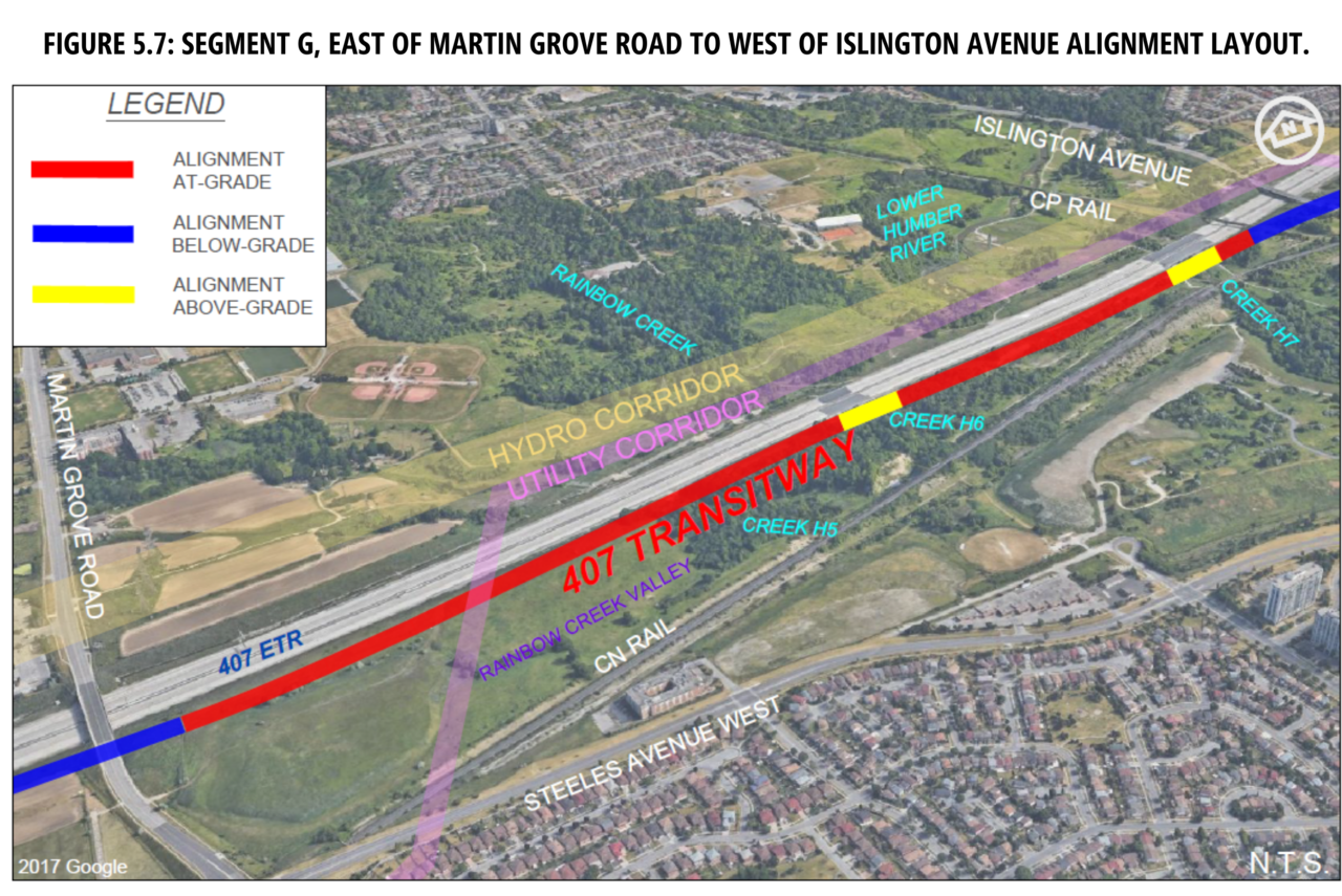

It's my understanding the 407 agreement requires land be set aside for a 407 Transitway. While only a couple lanes, it gets to be a tight squeeze in some locations like here where the CN track and hydro corridor squeeze in the highway corridor. Some of that can be moved but the price will escalate rapidly.
If expansion was to a, say, 18-lane core-collectors system similar to the 401 south of Pearson, you would need a minimum corridor width of about 100 metres for the highway itself not including any merge lanes or collector-express transfers.
That stretch is already 12 lanes and about 60 metres wide, so you 'need' about 40 metres of additional width.
That stretch in the image has about 300 metres between the CN rail line and Hydro Corridor - I'm unsure of the nature of the utility corridor in that image, but imagine that a 100-m 407, ~20m 407 Transitway, and utility corridor could be accomodated.
Cost escalation on pinch-points is definitely a valid concern, but most of the 407 has a minimum ROW of 120m with extras in many locations and plenty of spare land on either side on top of it's immediate ROW. The Transitway would be the biggest problem, but at a scale of investment such a project would be, not insurmountable.
