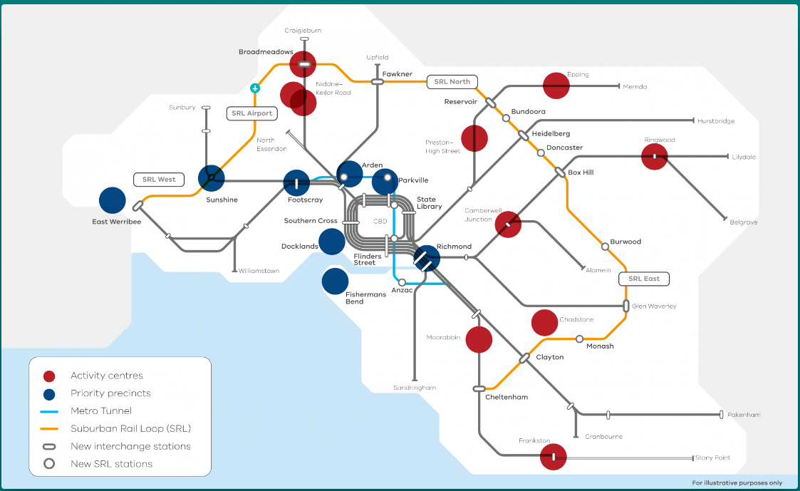

If it was $50b in capital cost (so opex et al is out of the total amount, obviously to be paid post-construction over X years), you'd probably get about 40-50km of driverless metro if it was built to a similar spec as Melbourne's SRL (which, oddly enough was lampooned early on and does a similar thing to what the 401 does: facilitates non-radial travel).
SRL East interchanges with existing radial lines (hello GO network) and adds two stations where there are none (one flagship university campus + surrounds which happens to also have the largest concentration of jobs in Melbourne outside the CBD (Monash), and another medium sized university campus (Deakin University, Burwood)). Each new station will have its own precinct (1.6km radius from the station) where the responsible authority (for approving new dev) will be the same authority that builds the rail line, overriding LGAs.
SRL East is 26km long, 6 stations, total price is looking at about $30-35billion (about 10-20% of that will be cost to operate over a certain period) - so $25-30bil to build and will created up to 70,000 additional homes across the 6 precincts.
So $50bil would be near double what we're building with SRL East.
(SRL East is Cheltenham to Box Hill - that's underway now, SRL North will likely be two phases: Box Hill to Reservoir and Reservoir to Airport - the full line to Cheltenham to Reservoir will probably end up around $50bil by 2040 and provide interchange to 8 lines [6 trunks] and provide catalyst for over 100k new units in the middle ring of 'burbs).
