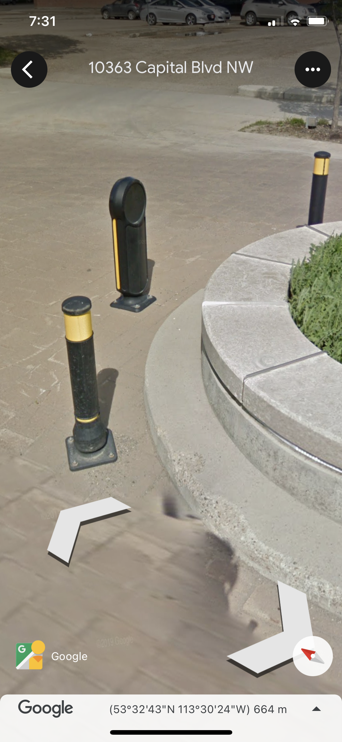

108st, er Capital BLVD, wants to have a chat with you and your outlandish thinking.
you mean the ones that were not part of the original design but needed to be added afterwards? the ones bolted to paving stones that still wouldn’t have prevented this?
