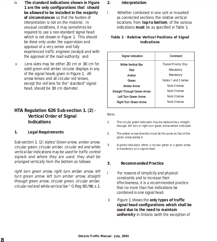

According to the MTO, the white bar "allows transit vehicles to go through, turn right or left, while all conflicting traffic faces a red light." I guess that last part is an issue. Also, the green turn signal means cars have right of way, which means pedestrians can't cross. General green light means cars have to yield to people crossing the street, which is what the city presumably wants.
The issue with the current vertical white bar in the HTA is a combination of what's written and the setup that has been used on the existing transit bars in Toronto.
As you noted, the HTA definition gives the right of way to transit going left, right and straight. But in certain jurisdictions, a more-restrictive definition has been used by the transit agency itself, to allow more efficient signal operations. In Toronto, the white bar has been given the meaning of left or right only, to allow perpendicular or opposing turns to occur simultaneously. For example, at King & Sumach the transit phase looks like this:

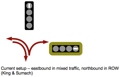

You can see that in order for the turns to happen simultaneously, streetcars cannot be permitted to go straight eastbound, because they would conflict with the northbound streetcars turning left. (In this case eastbound left turns are prohibited for all traffic). So in order for the Toronto meaning of the vertical transit bar to be changed to include (or only include?) straight through movements, the transit bars at intersections such as this would first need to be changed to something else. But the HTA currently only has the vertical transit signal, so there's no other transit-only signal to change it to.

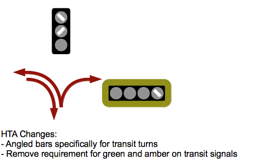

An obvious expansion of the HTA transit signals would be to introduce angled bars to represent turning movements, as per international standard practice. That way the current vertical bars could be changed to angled bars, and only then could vertical bars be used as straight-through signals such as on St Clair, Spadina or King Street.
In this diagram I also removed the unused aspects on the transit signal*.

*P.S.
HTA Reg. 626 s. 1 (1), states:
Every traffic control signal shall consist of one circular amber and one circular red indication in combination with
(a) a circular green indication;
(b) a circular green indication and one or more green arrow indications;
(c) a circular green indication, one or more green arrow indications and one or more amber arrow indications; or
(d) one or more green arrow indications.",
So legally, turnout-only signals on transit ROWs need to include the green and amber indications even though they are never used. I think this is silly and transit signals should be exempted.
The LRT signals in Waterloo are as per the North-American standard transit signal design, which violate this regulation in a couple ways:
- they don't have any green or amber lights
- the "red" light is actually a horizontal bar, not a circular red indication.
I'm assuming that the Region got some sort of exemption from the province to trial these non-compliant signals but I can't find any record of any. It's possible there is one but there's just no mention of it online.
