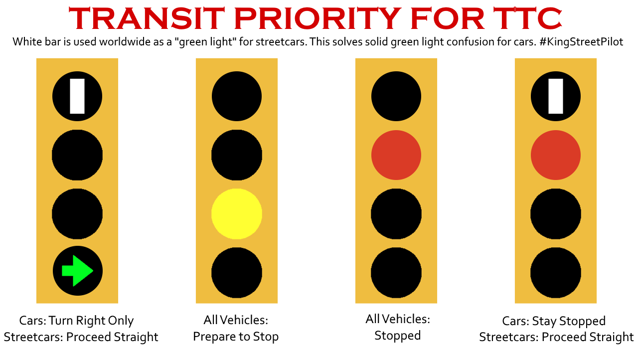

The current "green" signal phase would be replaced by this:
I like this, but with modifications to make better sense:
PHASE RED (all): Red light illuminated only
PHASE RED (cars only): Red light illuminated and transit priority illuminated
PHASE YELLOW: Yellow light illuminated (no other light)
PHASE GREEN: Green arrow (no solid green) and transit priority illuminated
The red light should never be permanently illuminated, otherwise, it conflicts with the other colors, and also breeds complacency.
Thusly, red light + green arrow will never be simultaneously illuminated, in order to avoid the "red permanently illuminated, unable to illuminate the solid yellow or solid green because red is permanently illuminated" catch-22 situation.
As a result, it would only have 4 lights:
- TRANSIT (WHITE RECTANGLE)
- SOLID RED
- SOLID YELLOW
- ARROW GREEN
Gibberish? How? It's been used in Toronto for years at turns without much issue. I don't see cars ignoring it - though pedestrians are a another issue.
See my post above. I think his diagram implies that red would be permanently illuminated, meaning there would not be any cycling except for the arrow turning on/off and transit priority turning on/off. That would not be logical for Ontario drivers, which is why I recommended minor modifications to TigerMaster's light.

Here's my idea for many intersections on King:
-- For pedestrians, it would illuminate separately (Walk will only illuminate during the red+transit phase), giving pedestrians their protected phase.
-- For bikes, use the same bike-logo signals used in Hamilton, Ontario (on Cannon St and Bay St protected cycle tracks) that illuminates at same time as walk signal. A very curious aberration; in Hamilton getting the first cycle-logo lights in Ontario that I know of:
(Hamilton, Ontario)
In Toronto's case, the walk signal and the bike signal (located nearer the walk lights for Toronto's case) would illuminate at the same time as the red+transit phase in the rightmost of the image above.
The city really needs to implement this idea. If they install the signals with the vertical white bar then the current ones can be reused elsewhere, right?
