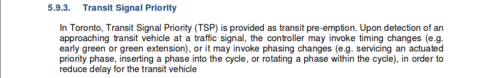

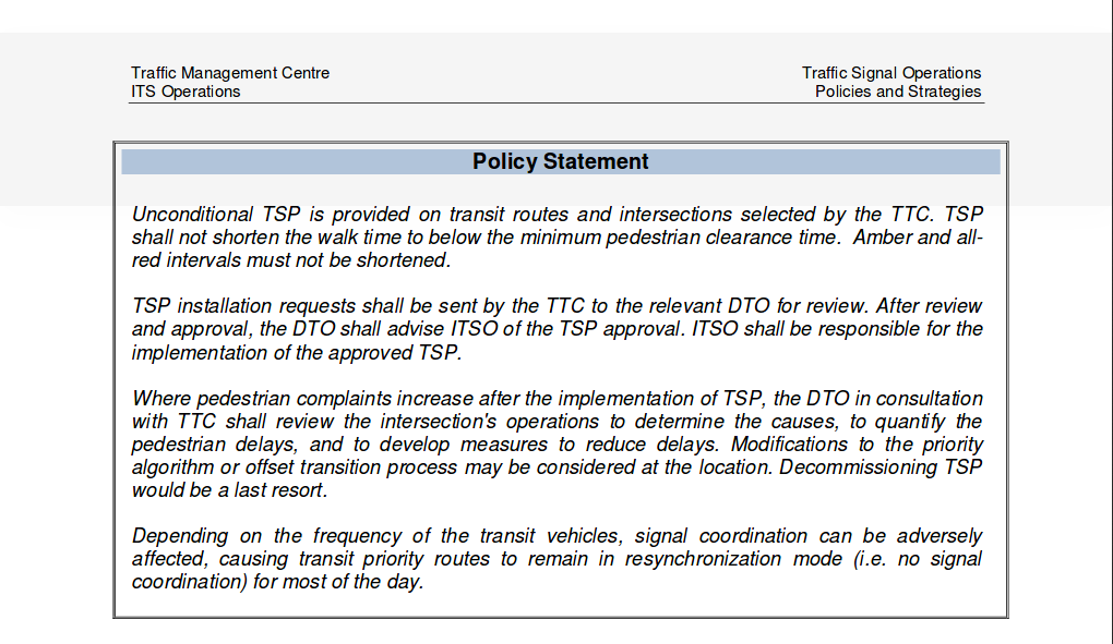

I was just reading up on Ottawa's priority system after reading a paper on the San Diego Trolley's long and developed approach to priority both with and w/o over-ride.
Just about to read this, but run out of time right now:
https://www1.toronto.ca/City Of Toronto/Transportation Services/TMC/Files/PDF/2015-11-13_TSOPoliciesAndStrategiesFinal.pdf
Note: "TSP shall not shorten the walk time to below the minimum pedestrian clearance time".
That could only be a consideration if the streetcar is turning at the intersection. For proceeding straight ahead, it's a moot point.
Something is not adding up with what other sources/posters state. Will continue to examine this and other docs later.
For going straight ahead it means that when a streetcar is approaching a red light, that light can't just suddenly turn green because first you need to wait for the pedestrian countdown to be completed (which is typically about 12 seconds for north-south streets at King), followed by about 6 seconds of yellow+all-red.
