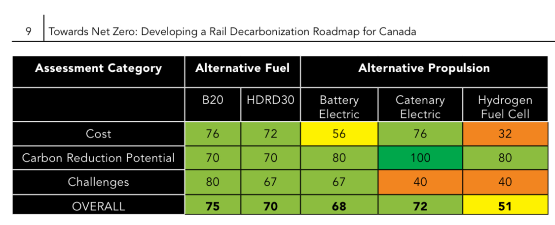

It seems like even the freight railroads own industry body is highly skeptical of Hydrogen’s potential in achieving “net zero”, especially on the all-important cost front:
Electrifiction could very well be the best route for Win/QC but I think CGY/ED will be hydrogen when Smith needs to show off the province's hydrogen potentil.
In the rest of the country with huge distnces & much colder temps, hydrogen is the only option to cut GHG emissions. Trying to string wires from VCR to HFX is ridiculously expensive. Yes, hydrogen fuel is more expensive but those prices r coming down quickly & will continue to do so due to the technology & infrstructure growing.
Some sort of a hybrid system would seem likely.Eventually Electrification where CN & CPKC do not own the lines and traffic volumes make sense. So GO for one, perhaps VIA on certain routes, especially where trackage is their own or shared with GO (for instance). And then diesel on the balance of VIA, until Justin gives them the money to make the Canadian greener. And diesel/hydrogen on the balance of the CN/CPKC and other short lines extending across both borders. Hydrogen being first a ‘testing’ fuel that then see’s some use on selected lines where the fit makes sense - both operationally and pr wise.
