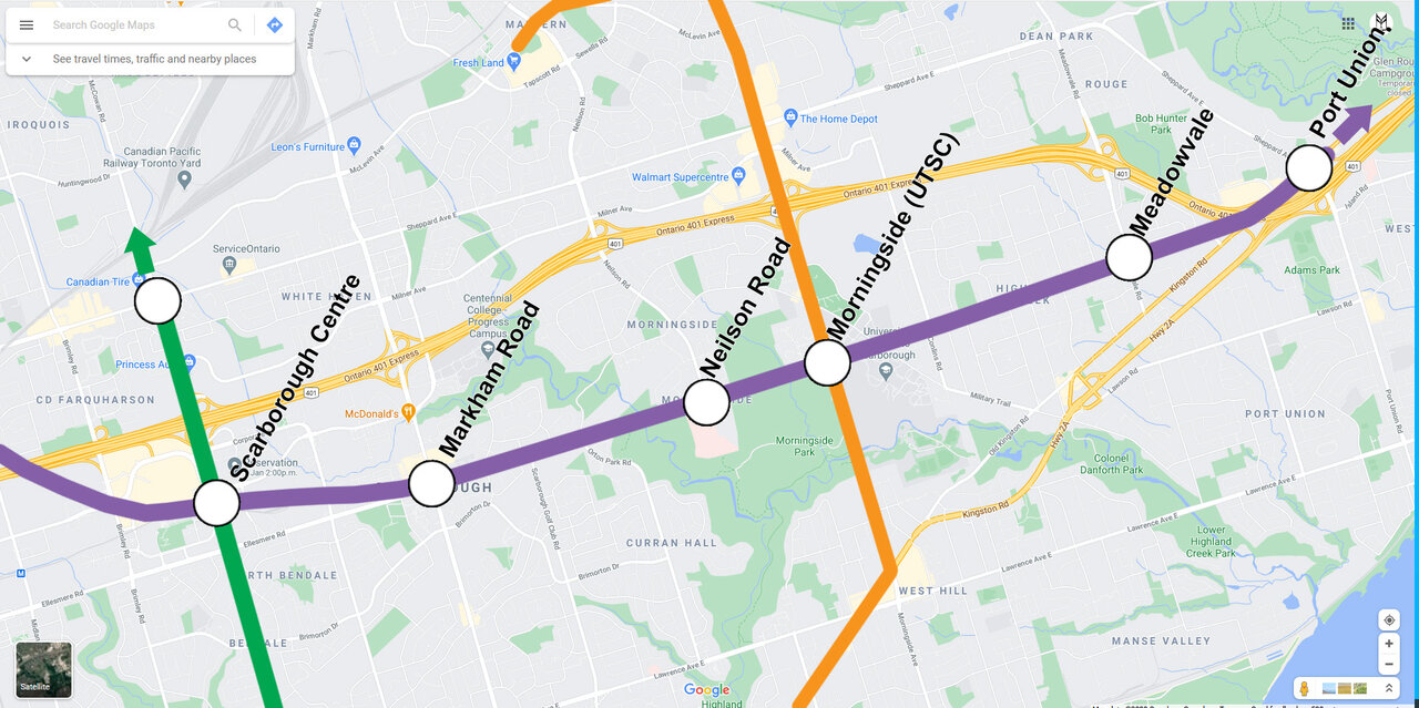

I don't think the 2 lines are going to be interlined and any connection to the two will be perpendicular and not parallel. I know some will make the case for McCowan and Sheppard, however I made my case for STC and STC also in my opinion has better extension potential. If the line ends at McCowan and Sheppard where do you go from there? Malvern? That's fine but that's really it. On the other hand STC would bring the Sheppard line closer to Ellesmere which opens up potential of extending the Sheppard line to UTSC and even into Durham via Kingston road if that's what you fancy. I also think crossing the Rouge Valley along Kingston would be better since its narrower then at Sheppard and there is more in the immediate vicinity then compared to Sheppard where after Meadowvale there is a whole lot of nothing. Service to Malvern can be handled by the Eglinton East LRT assuming it even gets built and still connect to the Sheppard line at Morningside or UTSC (wherever the Sheppard Line station would be built).

If you wanted to make the case for extending the Sheppard Line east past STC then it could look something like this. Obviously we should focus on getting the line to STC first but I believe STC and Ellesmere offer better expansion potential.
When looking at an elevated alignment for Sheppard east of Don Mills to me I can see the elevated structure being put down the middle of the road, and if the stop at the Scarborough Town Centre was to be underground then there is a large empty parcel of land on the south side of the 401 west of Brimley that you could put the portal. On the other hand I do wonder where the western portal by Don Mills would be since nothing stands out immediately save for a centre median portal. Heading west from Sheppard-Yonge to Sheppard West on that extension there doesn't seem to be a way to elevate the line so that extension would almost certainly have to be underground save for the crossing of Earl Bales park.
If people don't mind taken away 2 lanes (6 to 4) just west of Victoria Park then a centre median portal should be doable.
