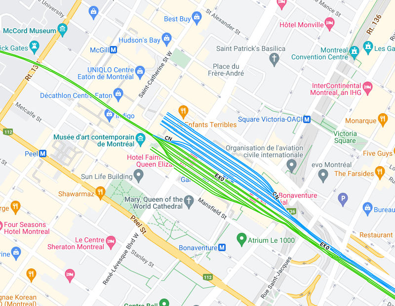

You can't build north from those platforms. They're not deep enough to clear the underground parking lots, the underground city and the metro green line that are meters from there.

Right. The only solution now, if it ever comes to that, is to build a new tunnel from the Parc station and build new central station platforms deep under the existing station. That tunnel would then have to continue west to surface along the CP Westmount sub, or curve to the south and reach the maintenance centres for Victoria bridge access (or both).
A good solution for now would be to build a connection before Parc station with the CN line and have the north bound commuter and Via trains stop at Côte-de-Liesse station (including HFR East), and the west/southbound trains operate out of Central station. In other words, a Boston situation but with a direct link between the two stations.
