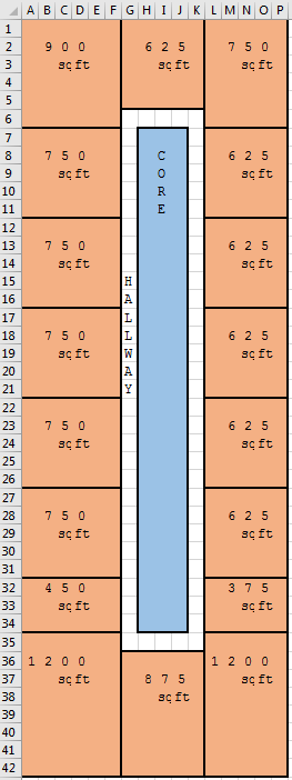

@Surrealplaces Milner's (streetview) floorplate above the podium level is 80'x210'. You have 30' from the core (width) and the heights from the core are 40' on one side and 25' on the other side. Really challenging dimensions to reallocate. My rough look at it was 60-65% efficiency per floor. But the plans look really awkward. You are a little too stubby with 30' from the core (by my understanding) as you need to put in a hallway so you end up with awkward 25' deep units (seen in ~520 sf sizes).

Yeah, as for apartments, the fit isn't awesome. lots of big one bedrooms save for the corners. The square one that was converted in edmonton last cycle also has oversized units due to the layout (click the floorplan tab).
For example, for Milner's floorplate:
