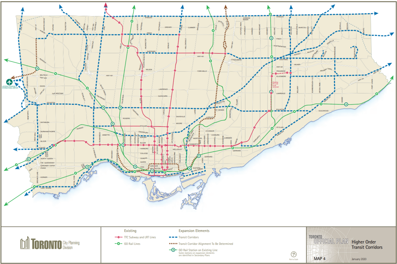

The actual current OP is:
Interesting to see that the official plan has the Ontario Line curving north to Roncesvalle, terminating at Dundas West station. One would assume with stations at Sorauren/Queen and Roncesvalles/Dundas/Howard Park. Had someone mentioned that being in the OP before?
