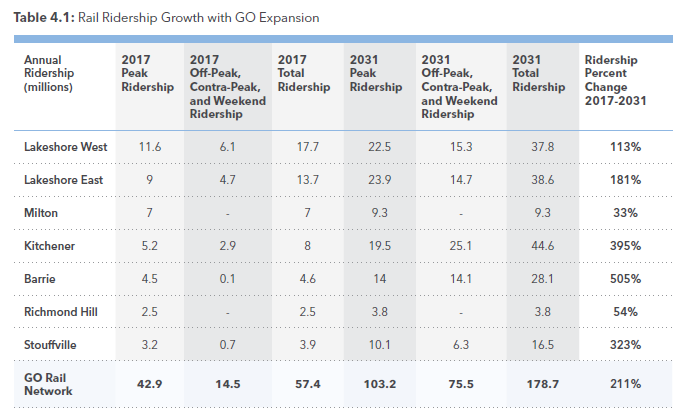

Stoufville line is planned for "two-way all-day between Mount joy and Union, fifteen minute service or better between Unionville and Union". The Metrolinx business case has its ridership increasing from 3,900,000 annual riders to 16,500,000 annual riders as per below. These details make me more hesitant about Victoria Park as the corridor of choice.
Even just looking at existing surface transit ridership numbers, Don Mills bus hosts 38,000 daily riders, compared to Victoria Park's 24,000 daily riders.
While I agree with the premise of the Stouffville Line effectively becoming an interceptor subway, using bus ridership numbers in this case may be a bit misleading. The Don Mills bus has the advantage of bus lanes (or at least HOV lanes) for a substantial portion of it's route, and two bridges on which it doesn't have to stop. The Victoria Park bus needs to slog down a mixed-traffic urban arterial for its entire length. Passengers on that corridor may be more inclined to take an E-W bus to the Yonge Line, while those on Don Mills may prefer to go south instead.

Why not look at replacing this service RH GO line) with an extension of the Relief Line?
Or *combine them* using the best of each to bypass the Don Valley section save for VIA and GO trains, and if enough speed can be attained, GO DD stock into Union during peak bypassing all the local stops down the Relief Line.
