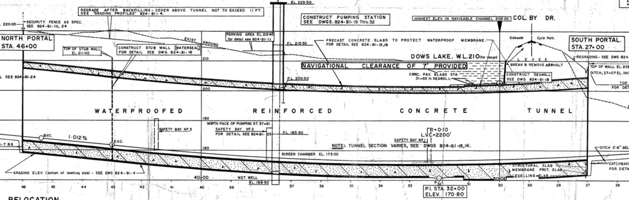

While that's a fun video it's not relevant in any way. The tunnel in question is several kilometers long, it's through deep rock, and it's already two tracks wide. The Dow's Lake tunnel is around half a km, has less than three meters of fill on top, and isn't wide enough for 2 tracks. The earlier plan to widen it was cut and cover, and involves clearcutting a swath of the Dominion Arboretum. A possible alternative could be using a road header to dig a parallel but deeper second tunnel. Any scheme resembling the Swiss video is pure fantasy.
To add a little detail, the Dow's Lake tunnel is 578 metres long and about 5.1 wide. As the Stadler trains are a little over 2.8 meters wide, you'd need a tunnel of at least 8 metres for double tracking. With its shallow depth, widening it by any means except cut and cover is impossible. Here is a segment of a 1960s diagram of the tunnel found on the Railways of Ottawa site. There seem to be roughly 2 feet of concrete and 10 feet of fill above the tunnel under the Arboretum, but if I'm reading the diagram correctly, there is only a thickened slab under the canal itself.
