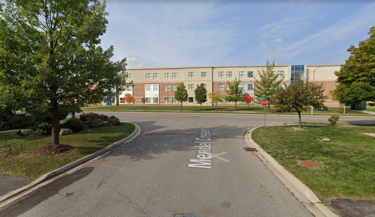

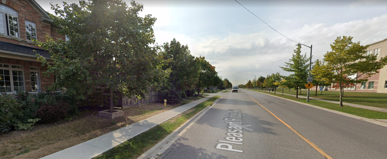

In respect of the above, a photo essay:
Principle street:
You can see the school to the right, the photo is taken from a non-signalized intersection, looking east, is that tiny yellow sign sufficient to indicate a pedestrian crossing? Are the wide lanes, straight road, and official crossing-free envrionment consistent with a 40km/ph speed limit? Is that limit reasonable in front of the school?
Intersecting Street:
Is the absence of a stop line reasonable? Is the absence of a marked pedestrian ROW/Crossing reasonable? Observe that there are no sidewalks on either side of the road. Is that reasonable?
(regrettably, adding sidewalks behind the curb on either side of this street would result in the removal of dozens of mature trees. It appears to be plausible to add a sidewalk within the ROW on one side, or alternatively to consider a shared street design; though the latter in so auto-centric an area may be problematic.
Is it reasonable that there is no crossing in the form of a crosswalk, a bumpout, or differential pavement from this street to the school across the way?
Is that sightline at the corner reasonable (left side of image)?
Intersection from where the first pic was taken:
At least there's a stop sign and stop line??
Aside from the extraordinary width/girth of a stop-signed intersection.............
Note the absence of any zebra striped crosswalk. Is that reasonable?
Are the turnii radii reasonable?

My take: Most of what I have shown is not reasonable in my judgement.
While any ruling here must have a pragmatic element to it, I would like to see a judicial order to the effect that a municipality must exercise due care to ensure that any sanctioned use of a road is reasonably safe for that road user.
-That a stated speed must be supported by a road design reasonably consistent with said speed.
-That a speed limit must be set which reflects the safety of all road users in light of sanctioned uses.
-That a foreseeable use against which no action is taken is generally a sanctioned use.

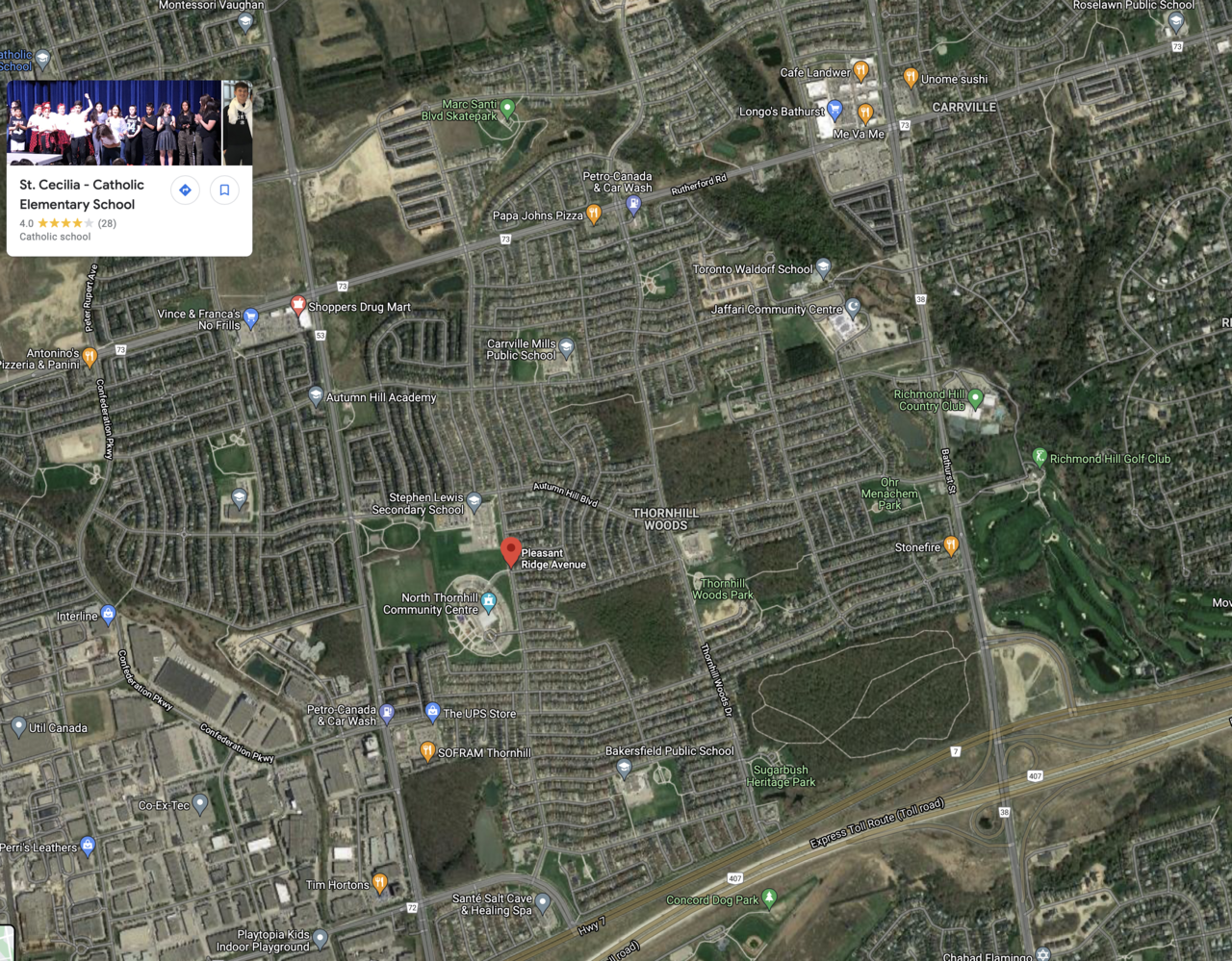

It goes even further when you stand back and look at the map. It starts with laying neighbourhoods out in a manner which increases non-auto transportation as the modal share (dare I say norm?)
In the area we're discussing, the question seems to be.... walk/bike to where? The entire civic infrastructure has been laid out in a way that pretty much guarantees that autos will have to be used for many trips. Step 2 of the solution is reconfiguring roads to be safer for non-auto use.... but step 1 is to put schools, stores, community centers, services in proximity and with reasonable distance for active users. For example, this neighbourhood needs at least one or two corner stores (possibly without parking) and maybe a pub or two in the middle. It's not hard to see how measures to curb auto throughput run contrary to resident interests when getting around by car is the most practical option.
An earlier poster questioned my claim that public schools create auto usage. My impression is that many parents drive their kids to schools these days....even if they are attending the local (and closest) public school. Just one example.

Principle street:
According to the HTA, one must stop before the sidewalk if no marking exists. Look and proceed when it's clear. Running through the intersection with rolling stops (which everyone loves) is already a violation and a ticket-able offence. No marking doesn't mean you're free to stop where you feel like it.
If there is no stop line, stop at the crosswalk, marked or not. If there is no crosswalk, stop at the edge of the sidewalk. If there is no sidewalk, stop at the edge of the intersection (Diagram 2-24). Wait until the way is clear before entering the intersection.
The obviously thing here is visibility. The tree on the left should be removed as well as the home at the corner shouldn't been allowed to plant things that obscure the line of view. That's why TO has taken down a lot of older bus shelters and replace them with smaller ones at a different location. So yes the city has negated their duty of care if enough complaints have already been filed.

As for the 40km/h limit. That is in line with the majority if the province. Wide lanes and straight roads are very typical and really bad design. Even lowering the limit to 30, people will still go 50 or 60 sometimes. Speed bumps, more stop signs, designated crossings and narrower lanes are needed to get people to slow down. This all cost money that they don't feel justified to install at every school. That's the problem.
