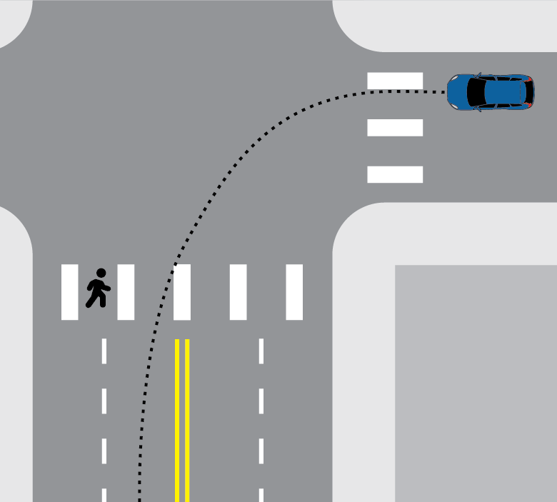

Interesting Study here on hardening the centre-line at left turn locations to improve safety.
It appears to show a very significant improvement.
Before
After
A picture is also included in the link; but does not appear to me to fully match the diagram.
I sent this VERY interesting link to my Councillor (Kristyn Wong-Tam and she sent it to Transportation. THEY just responded:
"You'll be happy to hear that, as committed in Vision Zero 2.0, we're planning out a left turn calming pilot based on NYC, Portland and other jurisdictions' work as we speak. We're hoping to roll out the pilot before the end of the year or early next year."
What else is there to say????
