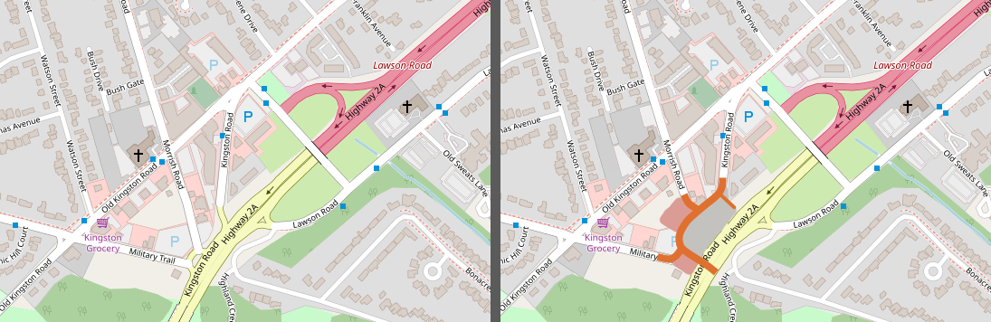

Edit: @north-of-anything can you draw a Highway 2 - Kingston Road reconfiguration map?

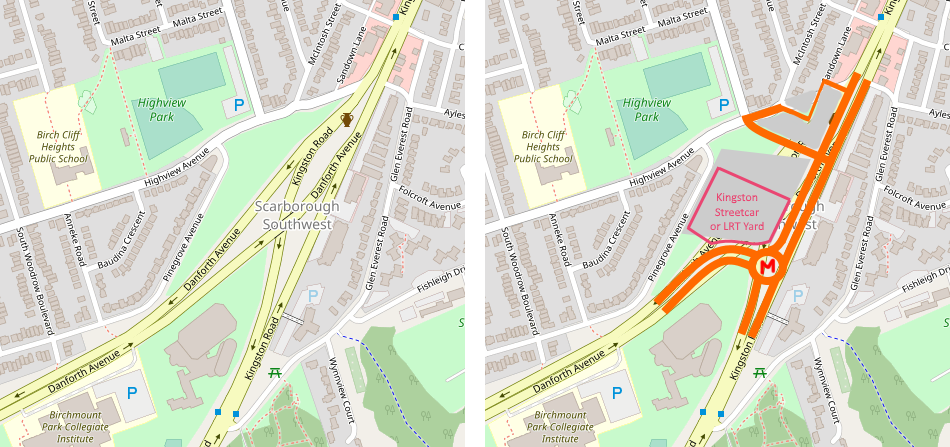

This is an idea I've had in mind since hearing about the Six Points reconstruction project - there are an unsettling number of this kind of urban interchange east of Yonge (that being, more than 0). So I redesigned this intersection to have a roundabout, with the Scarborough War Memorial located in the middle of the roundabout - it could be anywhere, but I think here it looks nicer, and any location would be more pedestrian friendly than where it is now. Part of the freed-up land would be used as a yard for rapid transit along Kingston Road. Kennedy Road would be extended at a sharp angle to terminate at Kingston Road, allowing two-way access between Kingston and the Highview Avenue neighbourhood. The land between the carhouse/LRT yard and Kennedy Road, if I did not underestimate the amount of space required, could be developed or left as a park.
How would you accommodate at-grade/on-street in a traffic circle layout?
Fun with maps!
^There are roundabouts with LRT tracks running through them no?
Nice. But I'd probably choose a different location for a potential streetcar/LRV yard. That area is prime for intensification. The interesting thing is that the flyover dates from the 1930s, and was built by the province to make Highway 2 a dual carriageway through Scarborough (with the later addition of Highway 2A from Highland Creek towards Oshawa). While I'd love to see it go, I still appreciate it while it's still there - one of the last remaining DHO 1930s structures.
Well, I tried!
I've never been anywhere close to this intersection, so I wasn't quite sure how much room I really had to work with. I opted on demolishing a pair of buildings on Morrish, and realigning Kingston Road so there are no longer three arterials awkwardly emptying into one-way ramps. I decided to keep the Lawson/Overpass interchange intact because there was a decent distance between the new intersection and the westbound ramps, and there is virtually no land that can be developed east of the overpass.
Well, I tried!

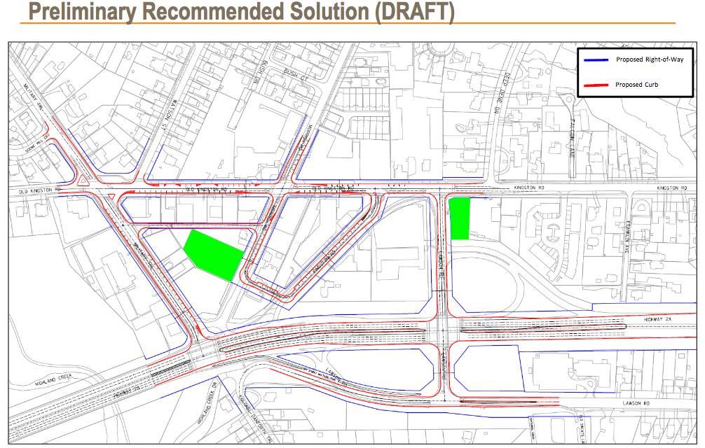

A few years ago the city in fact began a study to redevelop the roads in the area.

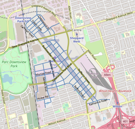

Basically, when Downsview Airport is decommissioned, the land has to be put to good use. I think the best way to do this is to expand off of the existing streets and private roads, as well as the Ancaster neighbourhood, to preserve some of the history of the site. Dufferin Street, Downsview Park Boulevard, Chesswood Drive, and much of Ancaster's grid layout are extended into the airport lands. I think this new neighbourhood would be a good testing ground for implementing gentle density between Bombardier/Beffort and Dufferin, considering its proximity to Line 1. The larger lots south of Katherine Road and west of Allen Road would be ideal for high density, and one could even be host to a sports or cultural venue supported by the adjacency to the subway.
