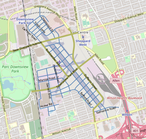

Basically, when Downsview Airport is decommissioned, the land has to be put to good use. I think the best way to do this is to expand off of the existing streets and private roads, as well as the Ancaster neighbourhood, to preserve some of the history of the site. Dufferin Street, Downsview Park Boulevard, Chesswood Drive, and much of Ancaster's grid layout are extended into the airport lands. I think this new neighbourhood would be a good testing ground for implementing gentle density between Bombardier/Beffort and Dufferin, considering its proximity to Line 1. The larger lots south of Katherine Road and west of Allen Road would be ideal for high density, and one could even be host to a sports or cultural venue supported by the adjacency to the subway.
However, please reserve some space for the Wilson Yard expansion, whether it would be used for the conventional subway trains, for Sheppard LRT vehicles, or for Sheppard OL-type vehicles. If this space is gone, it won't be easy to find an alternative location.
Also, would it not be a good idea to connect the two Dufferins at Sheppard? I know there's a bit of Allen Road north of Sheppard, but it could be renamed Dufferin too.
Dufferin already exists as a local road north of Sheppard - it's the one immediately east of Allen Road. Reconfiguring that would probably require reconfiguring the whole intersection, which is why I didn't actually label the street as Dufferin north of Downsview Park Blvd.
Wilson Yard could theoretically be expanded north, if Downsview Park Blvd is bridged over the yard instead of at grade.
I might do an alternate version when I get access to my laptop.

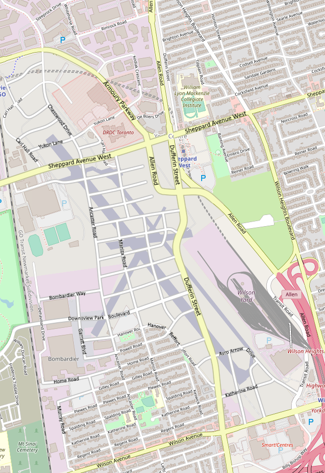

Improved! Also prettier!
I have no idea what would happen to the old Sheppard West so I called it "Armoury Parkway" to describe roughly what it is. I took some inspiration from the Six Points for putting together a new Sheppard-Dufferin intersection.
Nice, but I don't think having three major roads coming together at one intersection is a good idea. Too many lights and left turns in my view. Allen is the odd one out. I don't think Six Points should have been reconfigured that way either - Dundas screws everything up.
Can you make a map of the broader area with Allen removed entirely?
Allen Road removed entirely? The broader area? I don't get what you mean.
I don't really see that much of an issue with the number of intersections, since most drivers will have to make only one turn at most. There should actually be more space in between the intersections as there is in the Six Points area. If the short distance between Allen/Armoury and Dufferin is an issue, then they can just extend Line 4 westwards. It also doesn't really solve the problem of what would happen with the existing Sheppard Avenue West by removing Allen Road.

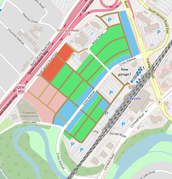

Presenting another idea for a new street grid over parking lots: "Oakville Midtown", which redevelops most of the property to the northwest of Oakville GO, and helps turn Trafalgar Road into more than just a connector between two (planned) dense areas.
The blue zones are the mixed-use, fairly high density buildings that would help create an Oakville skyline. The green are lower-density residential zones (think Cornell in Markham, or row houses), the pink zone is large-format retail, and the red zone is for a school. Light brown roads are less important than the dark brown roads. This arrangement preserves a fair bit of parking, owing to the largely suburban nature of Oakville, but I wanted to try for a balance between serving existing commuters and encouraging new transit-oriented growth.
(Edit: Tagging @t54zhao since they mentioned Oakville GO as one site of "wasted potential" among others.)
I would remove the Allen Connection to Dufferin that currently there and have only one connection in place of 2. Not sure how much traffic use Armoury Parkway and having another intersection close to Dufferin is going to slow traffic down. Rethink that connection.
The number of streets connecting to the new Dufferin St could have an impact on the flow of traffic on it. The speed needs to be 40-50km on the new Dufferin.
Also, allow more land for TTC to expand the current yard
What would be nice to see is a rail spur to Wilson Yard to allow new cars to be ship there by rail in place of trucks.
Need green space there as well.

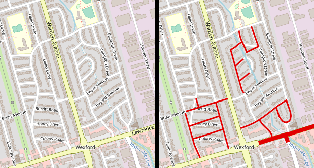

I didn't know this thread existed, but this is an idea I had for a reconstruction of a neighbourhood at Lawrence and Warden Avenues.
I made the land in the northwest corner of Warden/Lawrence more suitable for midrise development, and also removed some of the more awkward intersections and curves.
- The incredibly disjointed section of Boem Avenue west of Warden has been replaced with an extension of Brian Avenue.
- Honey Drive and Colony Road have been adjusted to be parallel with Lawrence, allowing for rectangular lots.
- Manhattan Drive has been truncated. It now begins at the Brian Avenue extension instead of forking off from Tower Drive.
The road layout in the area east of Warden has been altered as well.
- Roselm Road, which once connected to Lawrence, has been turned into a crescent, and Ellington Drive now begins at Guild Hall Drive at the east intersection with Roselm.
- The far curve of Twin Pauls Crescent has been removed, allowing Taylor-Massey Creek to return to the surface.
- Tweed Crescent, now Tweed Road, parallels the creek. A new road connects the south end of Tweed to Compton Drive.
Unfortunately, this kind of redesign will involve several address changes, as most of the altered areas and lengths lie at the beginning of the address scheme for that road (for example, 1 Tweed Crescent is at the fork with Compton Drive).
I like your idea for the Warden/Lawrence area; but it dos have a problem.
I can tell you that you need a larger set-aside for the Creek to be on the surface. Merely for regulatory flood purposes you would need no less than 30M either side of the creek.
Besides, if you wanted to bring back a natural green system on the surface, you want room for trees and a bike path on at least one side of the road.
To recover the cost of bringing back, lets say, a 70M wide corridor for the creek, and to be ecologically useful, getting the creek down to Lawrence Avenue.........
You would have to remove Roselm Rd. entirely; then to keep a road connection to Lawrence, and not go through the heritage church/cemetery..........
You would have to extend Ellington on an angle, and then have it meet Crawford at a set of lights; Ellington would have to bridge the creek.
I would be inclined to punch Bayard out to Warden just to get more dense developable space, as well.
Oakville is essentially already planning this. The densities they are planning are much higher than what you are thinking of though.
Your grid plans are quite good ideas in base form, but you make them too small. That size of block wouldn't work, the Right of Ways are too small and the block sizes too small to efficiently fit underground parking. Your high density zones along Cross are like 20m deep - that is not even enough to fit a tower floorplate, yet alone setback, podiums, loading, retail, lobbies, a parking ramp, and an efficient underground garage!
Also res typically needs 30m or so deep lots to function properly, again, not going to work. Plus you need Right of Way widths atop that which are not insignificant.
