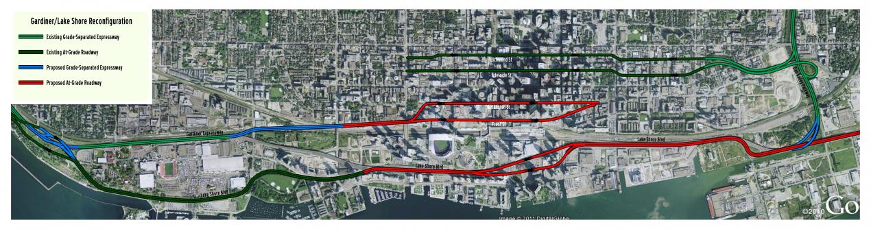

It is an interesting idea, for sure. The biggest issue with that though is what do you do when it reaches Union Station?
Personally, the plan I'm most in favour of is something like this, where the Gardiner gets diverted onto Front/Wellington opposing one-ways, while Lake Shore is reconfigured as an urban boulevard.
This would actually improve traffic flow, because right now the biggest constriction in downtown is getting TO the Gardiner/Lake Shore, as getting to either of them forces people to use a N-S road (Yonge, Bay, York, Simcoe, Spadina), all of which are congested most of the day. By having half the downtown-bound traffic on the Gardiner/Lake Shore combo coming into downtown from the west, and half from the south, it makes much better use of existing road infrastructure.
In addition, it's significantly less expensive than most options, because the bulk of the cost is a split between the tear-down of the existing expressway and the reconfiguration of Lake Shore, and the viaduct to be built from around the Ex to Front & Spadina. East of Spadina, there would be a small tunnel to connect to the viaduct, but by and large it would be a standard one-way reconfiguration of Front, and almost no work needed on Wellington.

Yup, pretty much my thinking...
