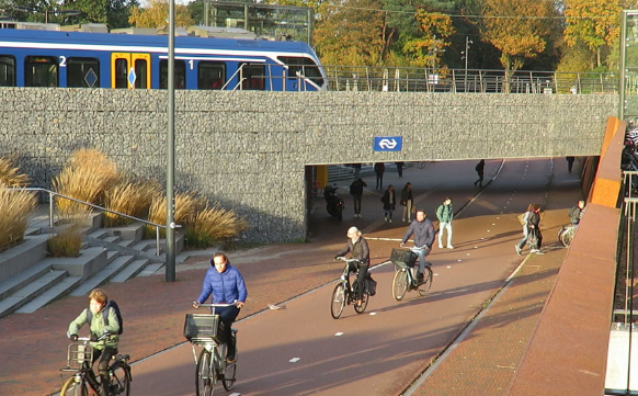

Our friends over in the Netherlands figured out the whole active mode underpass game forever ago for some examples of what a good one could look like:
A long one in central Amsterdam:
A short one with an interesting parallel story of adding an underpass and sorting out car v. active mode trade-offs:
https://bicycledutch.wordpress.com/2020/12/09/cycling-underpass-at-bilthoven-station/
To the point made by @ByeByeBaby , all underpass pictures show limited depth and width of the span. Keeps the slopes shallower and surely the effort/cost smaller. Less than a bridge? I don't know, but a shallow tunnel is easier to both use as a cyclist or pedestrian and eventually integrate into surrounding development.
