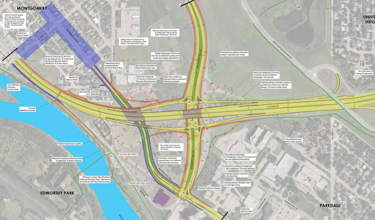

The 16th Avenue corridor study (Crowchild to Sarcee) goes to Transportation and Transit committee next week.
The administration report is here: https://pub-calgary.escribemeetings.com/filestream.ashx?DocumentId=167274
The executive summary of the study, including short, medium and long-term visions, is here: https://pub-calgary.escribemeetings.com/filestream.ashx?DocumentId=167275
Long term, it will be 6 lanes through Montgomery, with off-peak parking, or maybe 4 lanes with dedicated parking.
Wait... they're planning to add more car lanes to 16 ave??! A street that has been officially classified as a "main street"? Can we fire every single member of the transportation department and start all over again? I cannot believe they continue to think we can have some kind of compromise between increasing the car capacity of our roads and making them friendlier to non-car uses.
Yeah, it works just fine traffic wise -- whats the issue? is it they think removing the flyover ramps will break the road?
The key problem for the Montgomery 16th Ave plan is that it falls into the Calgary trap, that "compromise" or "balance" between transportation modes really means making everything wider all the time, rather than rebalancing existing footprints to be more accessible, efficient and safe for all modes.
For the only option in Montgomery that keeps the road to 4 lanes, 5.4m of the public realm is lost to the median. What's the point of this? A "wider public realm" shouldn't include an unusable strip of grass in the middle of an arterial. Add that width to the south or the north side and create an strip of urban forest to help meet the stormwater requirements or something. If the design speed is really only 50km/h, a median of that size is a huge wasteful over-design.
A bigger problem is another Calgary special: the consistent (implicit or explicit) desire to freeway-ify our arterial roads through design choices. 6 lanes in Montgomery makes it into this plan because to the east the long term plan is this for South Shaganappi:
There's lots of good things in this South Shaganappi plan - better bicycle/pedestrian connections, tightens-up (somewhat) all road geometry to theoretically allow land to be developed one day / some how. Same with the 16th Avenue corridor work - far better public realm, addition of on-street parking potential etc.
But more broadly, such a plan reveals the bigger bias I have commented on before on Crowchild, Bow Trail etc. - the underlying prime goal that is never traded-off is to preserve high-speed vehicle access everywhere, at every intersection and for all turns all the time. Some freeways and free-flow routes are important and critical, but Calgary has always gone farther: slip lanes, extra lanes, wider intersections with dual turns movements and long signal phasing everywhere we can possibly include them. With the goal to always move more cars, faster and allow them to go everywhere all the time, it's not really possible to create a good interface with a rare part of the arterial network in Montgomery that hasn't been bleached to be only a car-sewer.
Again it's not a bad plan entirely, just a meh one - it does a bunch of good things but overall just confirms the existing bias for automotive throughput and car commuters over local land development and other modes of travel.

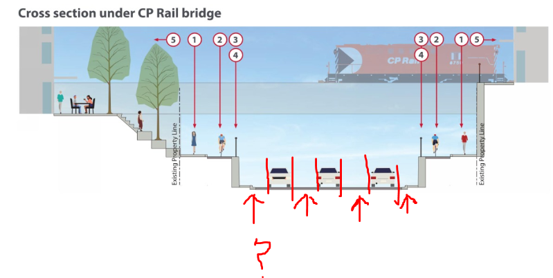

As cool as it would be to have a park instead of an underpass, I don't understand why I can't get a damn straight line sidewalk and a park in this city. Option 3 would be vote, followed by Option 2.
Also, can someone explain what the point of these extra spaces are in the road right-of-way and why they are worth it over a wider sidewalk or a shorter bridge/underpass length? So someone can get out of their car in the underpass? So they can upgrade to 5 lanes one day? So a large battle tank can fit through?
Yeah, the deeper it is, the more earth has to be moved, and the wider it is, the more strength you need in the rail bridge to span the larger gap. One car option (#2) has a bridge pier, which can take some of the load from the bridge -- all of the non-car options do, but since they're not as deep, the pier should be less costly to build.
My vote, honestly, is do a straightforward, slimmed down version of #3 and then take the savings vs. the other options and do the same thing at 7th St and 2nd St (the latter above the Green Line). The requirements for a good pedestrian / wheeling space are so much lower than that for cars, you don't actually need multiple 3.5 m linear plazas in an underpass, when every cubic metre of soil costs money, for a site that has a major park on one corner.

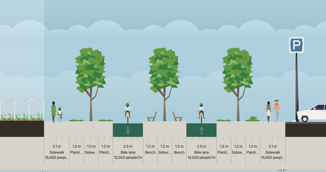

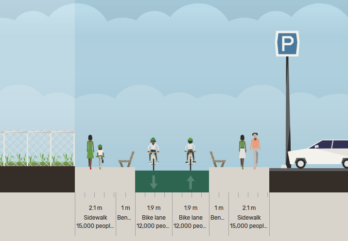

This:
costs twice as much as this:
for the same mobility benefits. And the recreation benefits for a site that's under a heavy rail corridor -- I'm not sure the City wants the liability associated with hearing damage from encouraging people to spend time there.

Great points and completely agree. Some of the wording is very curious on the benefits and drawbacks of each. As a pedestrian advocate in this city I’m always paranoid, but seems like institutional bias that can't imagine any street can exist without a car. I’m not convinced anyone has ever driven on 11th street to access transit downtown in the 100 years the street has existed. This is pure urban pedestrian territory for decades (even if it doesn’t look like it).
On the cost that’s why I’m so interested - if you slimmed down the active modes options to half their size, is it half as expensive? Because if it is this project should be for two underpasses, full stop. I’d rather have 2 new active modes crossings built simpler and normally than one fancy one, it’s a no brainer.
I gotta be honest, building an underpass just for bikes and pedestrians seems pointless. As nice it it would be I think we could used that money to improve pedestrian realms elsewhere. As someone who actually uses 11th Street a lot I'm not in favor of eliminating vehicle access. This is essentially the only railway crossing in the West end.
Option 2 would definitely be my preference, I'd love it if they planted trees to buffer between the vehicle and pedestrian realms. Maybe include some public art, etc.
