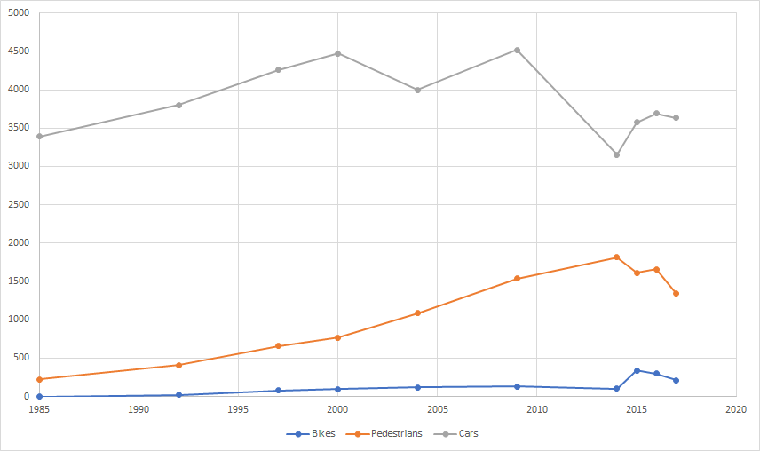

Here's the 6 hour counts from 10th Ave / 11 St:
The cars are the ones crossing the tracks; the bikes are the bikes on the north approach only; the pedestrians are those crossing the avenue. (The counts support more detailed analysis of cars, for some reason.) The 2017 count was on an unseasonably crappy day in September; the high that day was 8; I suspect that's part of why the pedestrian volume is down there. In any case, the long term trend for much higher pedestrian use and the long term trend for limited car use are both clear. Only one of the 60 hours in these counts was there even 500 cars travelling in one direction over an hour; that was in 1992 when 506 cars came NB in the PM peak.
Forgetting a bunch of data collection caveats for a second - you can really see that it is pedestrian volumes that track with high-density development in this area, not vehicle volumes. All that development along 11 Street SW since the early 2000s - some 1,000+ units immediately on 11th Street, many more a block or two away - pushes the pedestrian numbers up but holds cars steady. Another 1,000 units nearby and pedestrian volumes may pass cars altogether. That's not that far away if trends continue; perhaps 3 - 5 more towers over the next 10 - 15 years which is easily doable given what's in the development pipeline nearby. Another reason pedestrians need to be the dominant focus here.

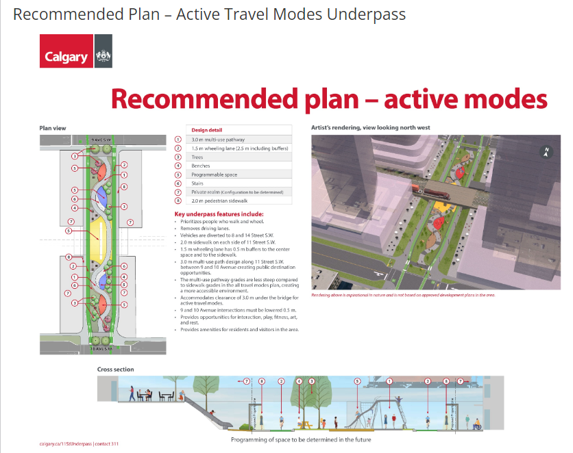

I'm glad they recommended the nonmotorized crossing -- and let me emphasize that, good job. But what a braindead design.
The functional need of an active mode underpass is two sidewalks, which they have designed at 2.0m each and two cycle lanes, at 1.5m each. That's 7m of width; up to 8.5m if you add the buffers planned on the sides of the cycle lanes.
I imagine it's really expensive to build a bridge under an active freight railroad, and the bigger the span, the more money it costs -- you both need sturdier horizontal beams to support the tracks, and to add columns if the span is wide enough.
The need is for a 7-8m underpass; the design is for a 23m wide underpass, wide enough to require columns in the middle supporting it. And for what? "Programmable space", which is architect-speak for "we don't even have an idea for what to do with this space at this point". If the underpass existed today with these dimensions, this would be an excellent design for how to use it. But it doesn't exist, and every metre of rail bridge costs millions. Why design three times what we need?
We can still have 90% of the public amenity space on either side of the underpass without the added cost, and it's the best 90% because it's not under an active freight railroad. Potentially there's enough room to add a little length to the sidewalks/cycle tracks so that the intersections at 9th and 10th don't have to be lowered by 0.5m either, another cost and disruption savings.
Would it be as nice as the plan? Absolutely not. But it would probably cost a small fraction of the plan, and instead of being a $75 million plan on the books, maybe it could be a $15 million project open and making people's lives better. And I suspect it's also more politically feasible -- a lot of people think that every road needs to have cars all the time, and when they ask "why are there no cars here?" the answer "we're saving you $60,000,000" will go a long way.

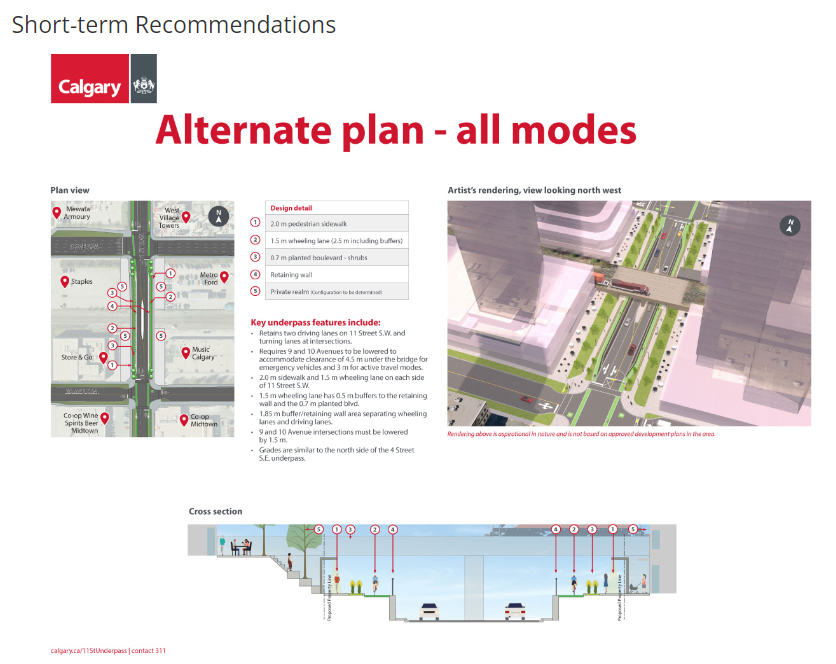

Would be stupid to go to the effort & expense of building an underpass below the CPR tracks and then not allow vehicles to use it.
More connections between downtown & Beltline the better.
There is plenty of room for all modes of transportation here (including vehicles) and still lots of green space as shown in the Alternate Plan.

The idea of spending ~ $100 million to actually worsen connectivity from the status quo is completely absurd. If we are set accommodating active modes only, then an overhead bridge (23' clearance required) would provide better functionality and bang for buck.

I agree with this - nothing prevents a park on either end but the really expensive part (by pedestrians/cycling infrastructure standards) is the underpass. Sure it'll be cheaper than a deeper and wider all-modes underpass, but the span needs to be nowhere close to that extensive to offer the full practical benefit of the active modes option. That should be fully tightened up and save all that capital for other things that make the connection even more valuable (e.g. like making permanent every cycletrack in the city centre, widen every sidewalk within 4 blocks etc.)
Essentially build this but with some more park amenities on either side:
If you can do it cheap enough by cutting out all the unnecessary width and depth in the park proposal you could probably build 3 of these underpasses at Sunalta, 11th, & 7 Street for the same price.
