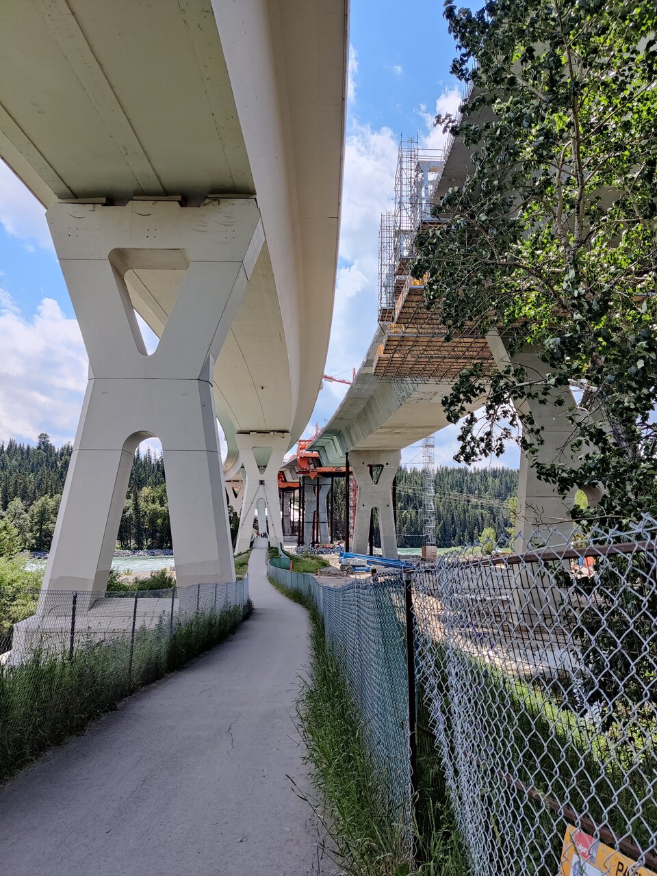

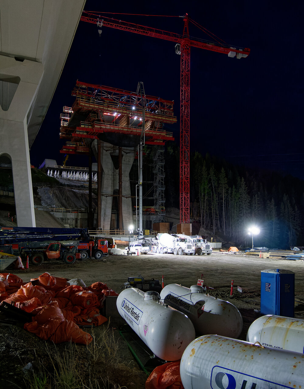

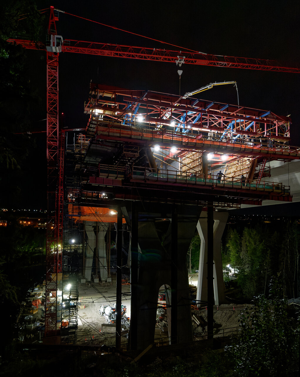

Working late on the Stoney Trail bridge (taken a few days before @Myles86's pics):
