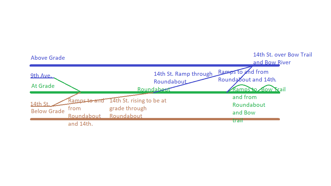

Had a couple minutes and quickly drew in paint an idea for how to fix the intersection of Bow Trail Westbound, 9th Ave. Eastbound and 14th St. West... I just got back from Europe where I noticed they do something there I hadn't thought of; they integrate a single roundabout into interchanges... not like we do with the Flanders thing. So here we go:
Green lines on the map are roads at grade, blue is above grade and brown is below grade. I'll include a cross section that hopefully isn't too confusing.
Quick explanation is that I hate this section of road so I wanted to find a better way. I think traffic circles are efficient when there isn't one or two directions that dominate it. A lot of what's there actually stays the same; Bow Trail is Westbound traffic only and goes under 14th St. West, 9th Ave Eastbound traffic only and goes over 14th St. West, and there are no traffic lights involved so traffic still free-flows through the area.
What I've changed is I've ran 14th St. West right through the roundabout, but still given drivers on 14th, 9th and Bow ramps to access the roundabout. The roundabout is at grade so the south portion goes over 14th while the north portion goes under it. I even added a local access road off the roundabout for what businesses are there now and hopefully the development that will fill the area whenever the soil gets remediated. I think with the local access road you could eliminate all the entrances and exits off of 9th Ave and Bow Trail to the adjacent properties (excluding the ones just south of 9th Ave.
I'm obviously no expert, what you can't tell by the paint drawing, but this is better than what's there now isn't it? You could even build up the roundabout to be level with 9th Ave. and have 14th St. go right under it before it has to go over Bow Trail and the Bow River? Then you could stick some art in the middle of it (everyone's favourite).
Here's the cross section
This isn't and won't ever be a big LA-style intersection of major roads (I think I maintained go flow and still gave drivers access to go from say 9th Ave to Eastbound to 14th St. westbound if they wanted), so I don't think you need some big interchange but maybe I'm wrong...

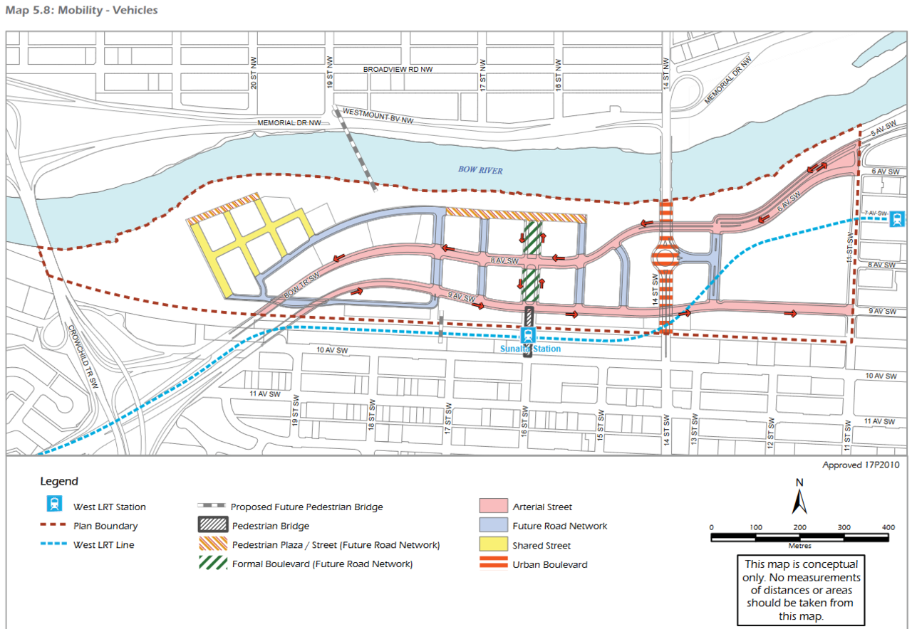

Or you just save a boatload of money and slow down the traffic on Bow Trail, like in the approved 2010 plan:
You had that in holster! What's going on with the 14th here? I see its an Urban Boulevard but is it above grade, below grade? On Bow trail it looks like there a median straight through it so there's no way its at grade?

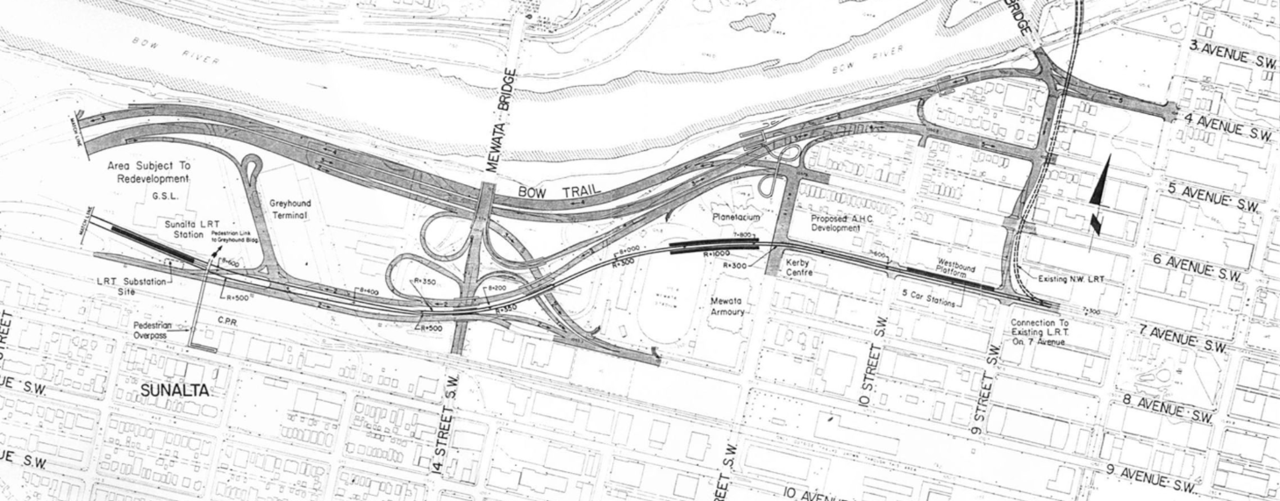

Sorta like this?:
