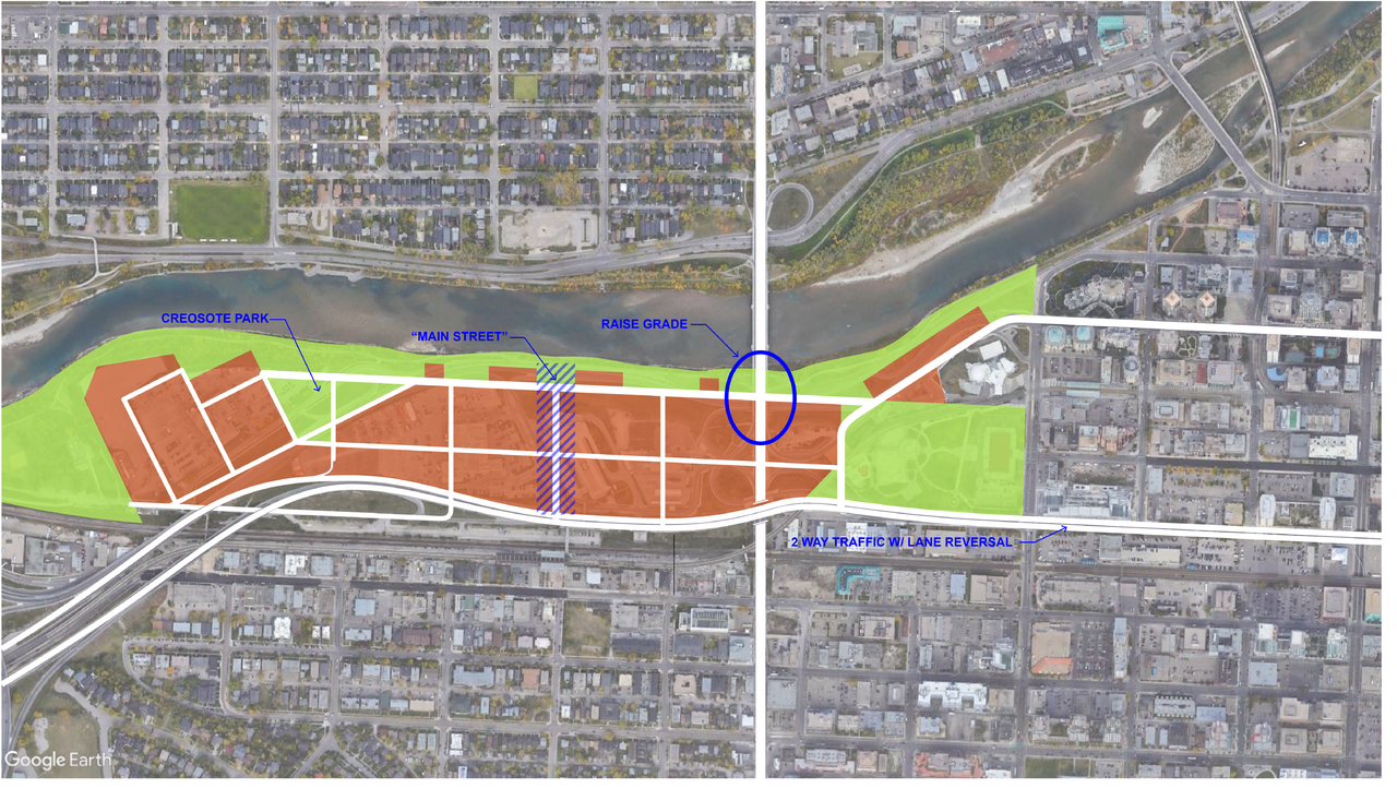

Because I'm a huge nerd, here's how I'd do it. Push as much traffic as possible southward close to the tracks. Essentially write-off 9th Ave as an urban street and make it into a two-way artery - add lanes where possible with a lane reversal to achieve the capacity. 9th becomes a Calgary version of West Georgia Street. This creates a much more pleasant riverwalk area, and with less space dedicated to roads, we have room for small scale riverfront developments similar to M2 in the East Village.
I guess the question I've landed on is whether it makes sense to use WV for typical resi/commercial development, at all. I'm sure developers would love the blank slate to draw up a bunch of empty promises, but I think there is immense risk it flops like Eau Claire. I just don't know how long until it would make sense to begin, but there are tons of lots in EV, near Eau Claire, north Beltline, Sunalta gentrification, etc...I don't know if it makes sense to flood the market with more dispersed urban supply instead of targeting more concentration where there is already some traction.
Or, is this a rare opportunity to check off a whole bunch of other boxes? Tucking Bow Tr close to the CP tracks might still make the most sense, or you trench them to 4th/5th and set your sights on 6th/9th as better urban boulevards (9th being a bit of a pipe-dream, but I'd argue that any improvement there would do more to help the overall DT core than WV development would). Of course you could still leave some choice plots available in WV for more typical development...I just think it's a fun spot to dream big.
On the financial opportunity cost standpoint is where I think partial redevelopment of Shag GC could offset things - and also just be a general improvement as the current golf course has surprisingly hostile barriers. Or, would WV actually be a better location for a fieldhouse (not CNext), leaving more land at Foothills for other development?

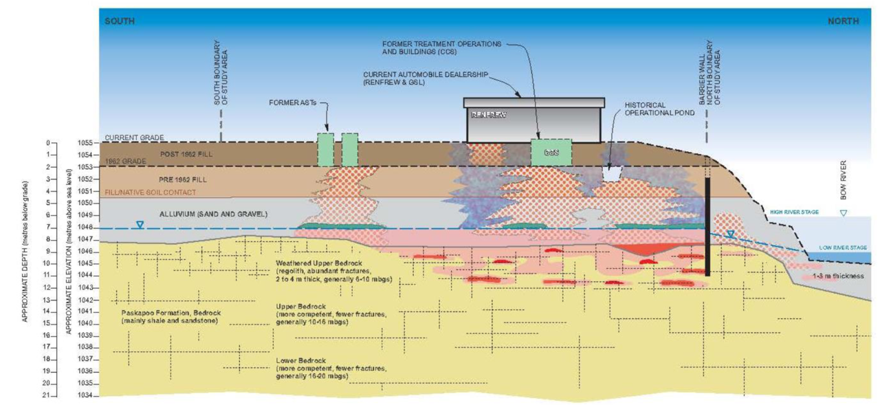

There is no plan b, the creosote will need to be cleaned up 100%, otherwise it will stay there forever, it is a preservative after all. The part that nobody wants to deal with on it is who pays to clean it up.

It would likely be possible to have park space without remediation. From a risk assessment perspective, there would be minimal exposure (no exposure to ground water, no exposure to soil (assuming it is capped with clean clay fill), and minimal exposure to vapours (well ventilated for short periods of time).
Corktown Common in the Canary District in Toronto is a park build largely on brownfield lands thy were not remediated.
The greatest risk would likely remain to any contractors / utility workers who migh disturb contaminated soil, but that can be addressed through proper planning.

Park is optimum imo. 55 acres of urban park. Development is sorta a chicken and egg--need money to do something, no money, land sales will generate money, land sales need high level of remediation, density will provide best source of money.
Contamination is mostly under a couple meters of soil.
