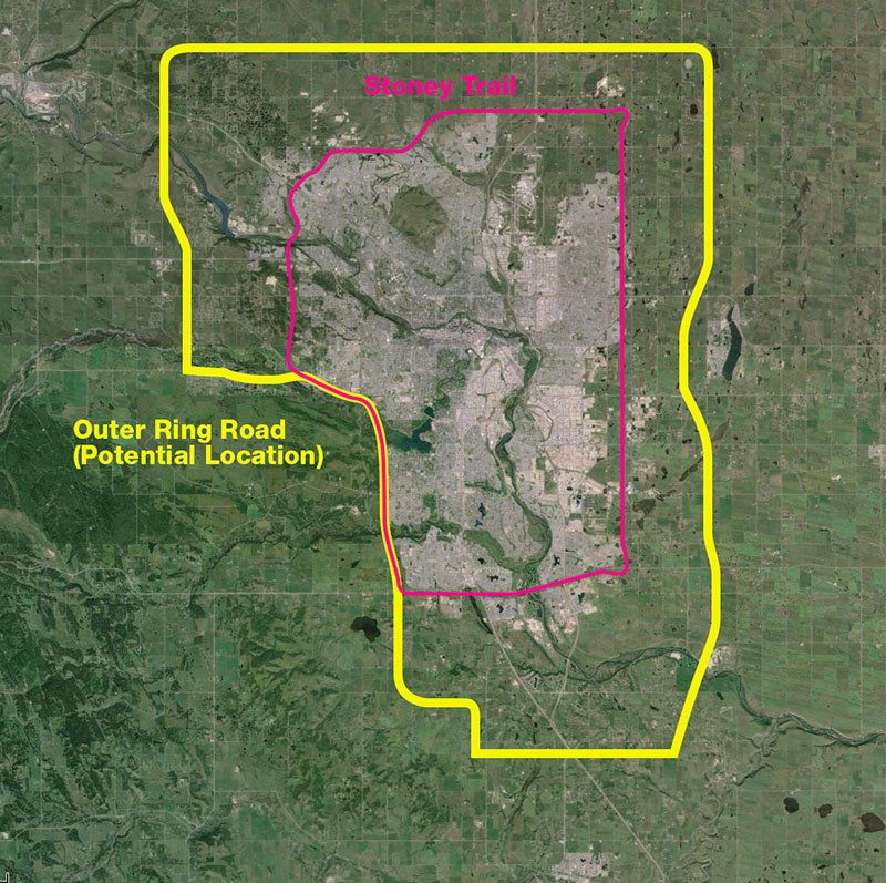

I recall seeing an old ring road map that not only listed more or less the current one under construction but also where the next one might be located. Probably something from the 50s-80s. Anyone remember or have that handy?
Something like this:
from our friend @JesseLikesCities
I remember seeing a similar black and white map from the province once--Jesse also saw it and based his map on his recollections, but it seems to be down the memory hole now.

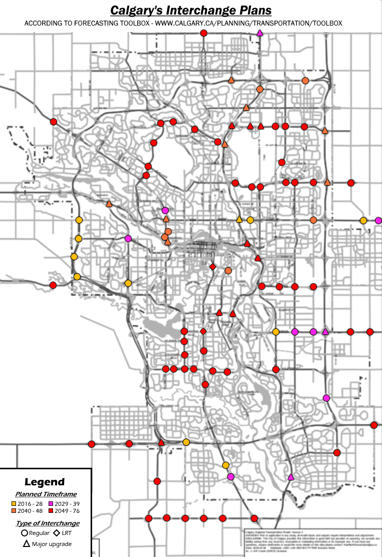

Lol what? The Deerfoot/Glenmore interchange won't be corrected until the city is like 2.5 - 3 million people? (2050 - 2076)
That's f*cking stupid.
The upgrade of that i/c in 2050-76 is from the Blackfoot/Glenmore interchange being upgraded, which will also reconfigure the Deerfoot/Glenmore one as a result. I honestly wouldn't be surprised to see a Deerfoot/Glenmore reconfiguration much earlier given the plans to expand the number of lanes on Deerfoot. The forecasting toolbox is primarily for, well, forecasting, so it's important not to view it as dictating the order of things.
This is really important. The toolbox and all the published materials on that site are based on assumptions which in general favour the status quo - basically they can't predict policy or economic changes so they baseline to 2015 then apply growth rates and mode share assumptions over time. They really aren't a prediction or plan for the future. Just a calculation using those assumptions projected forward.
Unfortunately they didn't publish the full methodology so we really don't know what we are looking at - I would assume some combo of business as usual / achieve the development plan baseline.
Most importantly, the baseline can always change - Vancouver famously decided to assume no new traffic lanes for cars back in the 2000s. They updated this type of forecast map and guess what - it removed all projected interchanges or highway expansions because the assumption was we don't build those anymore. They were no longer "needed" on any timeline simply because we assumed they weren't needed. That's how forecasting works.
In the Calgary forecast, the 2076 park and ride assumptions assume zero change in existing park-and-rides, which would be unrealistic. Consider that 2076 (53 years from now) is farther in the future than 1981 was ago (42 years ago) when our LRT and modern park-and-rides began. We are already discussing removing some park and rides for future development, surely a city of 3 million would redevelop some of them by 2076. Would we even have parking in 2076?
So forecasts and maps are interesting stuff, but we should be really suspicious of "needs" based on these kinds of forecasts, as it's assuming a bunch of status quo things that we may not actually want, or stuff that shouldn't happen or can't actually happen. It's just a tool for exploring options, that's all. If you ever go to an open house for a interchange, don't let a highway engineer try to trick you with one of these forecasts as the only proof we "need" to build it.

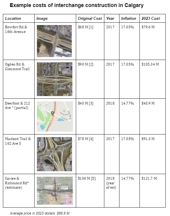

No kidding. I made this for fun, but if you start to do the math on how much this should cost, it shows just how mind-bendingly expensive following this model would be.
The toolbox forecasts 99 interchanges and upgrades up until 2076. Let's take a look at some of the most recent interchange projects in Calgary to get an idea of their costs:
(sources:
[1]-https://globalnews.ca/news/3706937/...ada-highwaybowfort-road-interchange-thursday/
[2]-https://calgaryherald.com/news/local-news/new-glenmore-trail-and-ogden-road-interchange-partly-opens
[3]-https://majorprojects.alberta.ca/details/Cranston-Seton-Interchange
[4]-https://majorprojects.alberta.ca/details/Macleod-Trail-and-162-Ave-S-Interchange
[5]-https://www.cbc.ca/news/canada/calgary/city-council-sarcee-interchange-ring-road-1.4527556 )
So through very crude math, $88.8 M * 99 = $8.79 Billion. That's an eye-watering cost. Even if you cut it by half it's still a ridiculous figure.
And that’s just for interchanges; it doesn’t even count the huge list of roadway expansions we’re also planning to build.
These kinds of projects almost never receive scrutiny, and it seems like they can sail through council with full support because they’re always perceived as “desperately needed to relieve congestion”. But I think we need to take a bird’s eye view of our transportation policies and really ask how much sense they make. The taxpayer burden of turning practically every major road into a freeway is just absurd, and it would hurt us in so many other ways.
This is especially important given that research from 500+ cities has shown that roadway expansions don’t really solve congestion longterm, whereas congestion pricing and good public transit do. (source: https://academic.oup.com/joeg/article-abstract/22/5/931/6333639?login=false)
All that’s to say, I think we need a paradigm shift in Calgary. I’m considering making a post about this on reddit, but before that I’d be interested to hear people’s thoughts and counter-arguments.
