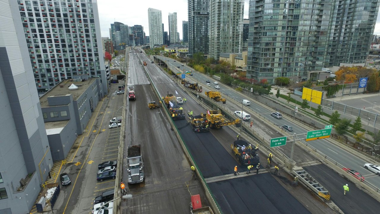

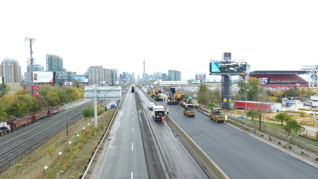

Gardiner was closed this weekend. Found these shots of some of the work being done on Linkedin.
