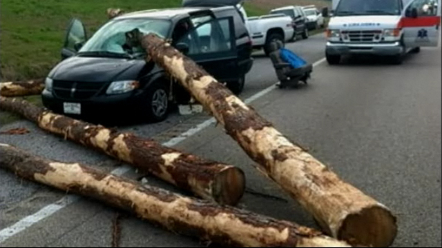

Until the truck is stopped but the load goes over, then it needs to be 5m high.
