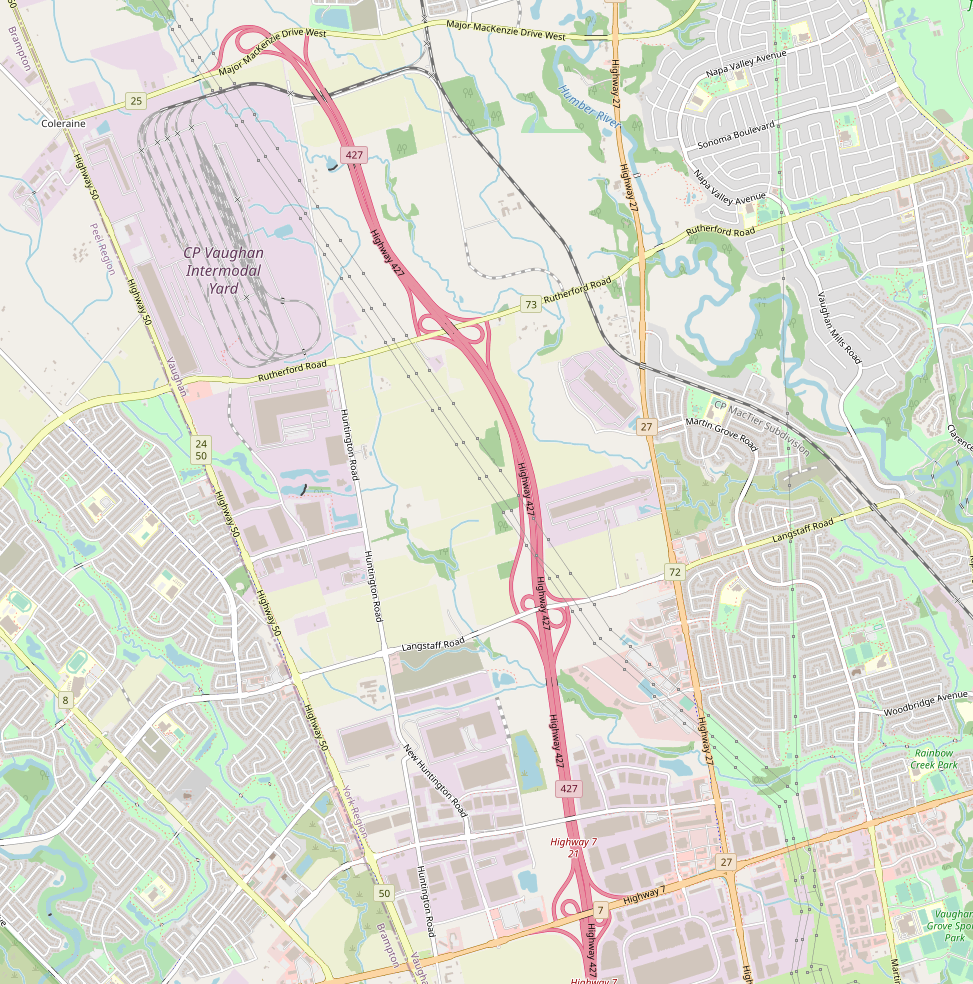

At least we got to see how the highway performed ending at Highway 7 which is even worse than the Zenway ending. As today is the last day we’ll see the insufferable bottleneck from Finch-Hwy 7, i would like to say thank you to finally opening the extension, and hopefully the highway flows better overall.
^ Interesting the way the 427 ends at Major Mackenzie... was not anticipating that sort of ramp pattern. When the 427 was originally extended to highway 7, they built a traditional overpass, in anticipation of the highway being extended further.
The absence of a traditional overpass at Major Mackenzie makes me think that it will be a long, long, long time before we see any form of further extension (or materialization of the GTA West highway/413).

The route westbound to Major Mackenzie leads right to Coleraine Drive, which is the southern section of the Bolton bypass (Regional Road 150) being built by Peel Region. That will send the trucks destined for Canadian Tire, Amazon, and other big warehouses on their way, avoiding Highway 50 completely.

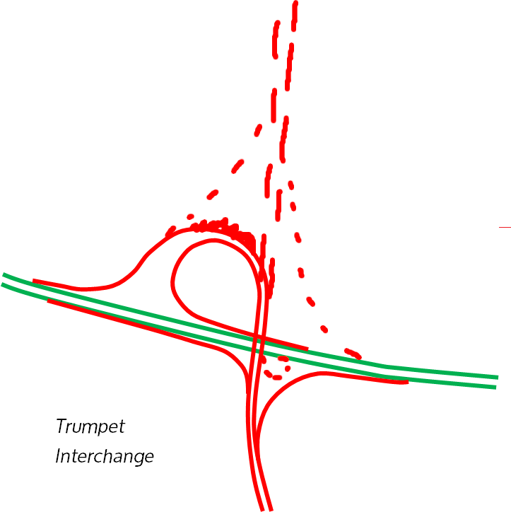

Actually no. The thing about Trumpet interchanges (what we see here) is precisely that they are designed in such a way to make them easily convertible to A4 Paclos.
If we look at the diagram here that I edited in GIMP in 2 seconds, if we get rid of a few key sections you can basically turn it into an A4, and this is with a trumpet design that isn't favourable with conversion. While its hard to properly see in the video above, the off ramp to Major Mackenzie Eastbound is built 90deg parallel to Major Mack so it can be converted to a standard A4 offramp, and you can also see in the video that it travels quite a bit of distance from the highway so adding a new loop for a northbound on ramp would be quite simple. In short, this interchange is designed for future extensions, this isn't the end.

The only difference I see is that the old hwy 7 interchange had a single ramp from the northbound lanes leading to a signalized intersection where drivers can turn left (west) or right (east). The set up at major mavk as someone mentioned is more suitable for a future extension northward
