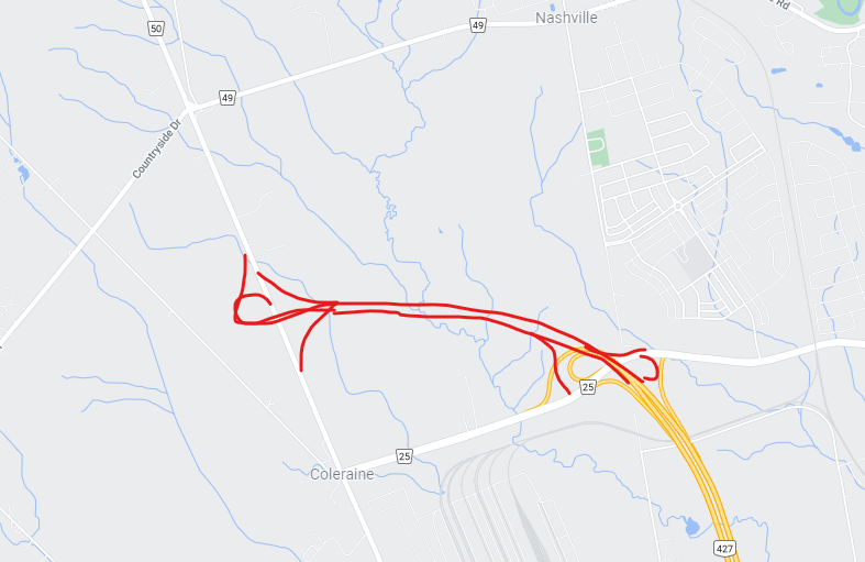

They should've integrated it better into Hwy 50. Maybe something like this:

Those problems are planned to be addressed relatively soon, or at least the Highway 50 problem. York Region is planning to widen Highaway 50 to 6 lanes through that stretch in 2024.. so still a few years off. I'm surprised they didn't add a second left turn lane sooner though. I wouldn't be surprised if that intersection is accelerated. The right turn problem probably isn't going to go away entirely though, at least until Coleraine Drive gets upgraded. Not sure on the timing of that one. York Region will probably build a right turn merge which will increase throughput, but not eliminate that issue.

The previous Highway 50-427 connection at Highway 7 has a right turn merge lane and double left turn lane to deal with the volumes. Now a lot of the traffic has been shifted north to Major Mackenzie. While Major Mack has been widened from it's previous rural sideroad condition, the intersection with Highway 50 hasn't been touched. So major highway level volumes are running through an intersection designed for very, very low traffic volumes. So yea, It doesn't work.
Once the intersection is rebuilt to deal with the actual volumes to be expected, it'll work much better.
