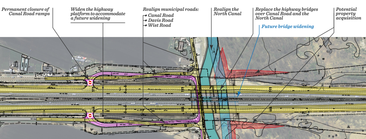

Are there any plans to get rid of the atrocious at grade ramps on the 400 at Canal?
A much earlier post, somewhere, said that it will be closed when lanes are added to the 400, which can't happen until all the bridge work is done.. Not sure I'd call it "atrocious" but it does seem to be quite the anomaly and I'm surprised it has survived this long.
the 400 Canal Rd "interchange" is going to close when they begin work on replacing the North Canal bridges, which are currently scheduled to be replaced starting next summer. So it's not long for this world.
heres the offical plans ... seems they are going to outright eliminate them... with no replacements. Interesting... http://hwy400ncanalbridges.ca/docs
