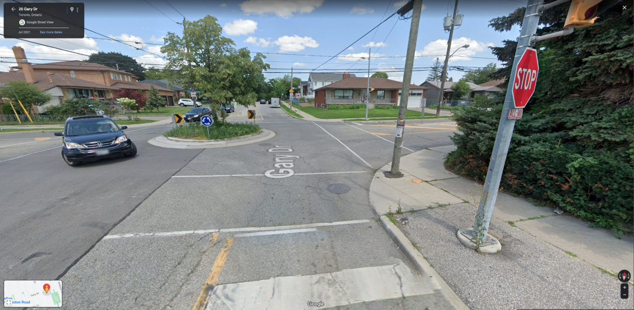

There's a similarly stupid set up at Gary and Wendell in the Pelmo Park area.

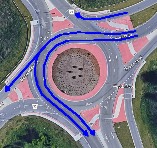

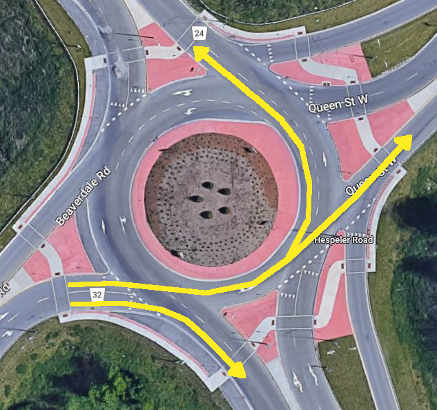

I think you may be misinterpreting the meaning of "not changing lanes in the roundabout". When you enter a multi-lane roundabout in Ontario you may need to cross other lanes to reach the lane which leads to your destination (see for example, the left lane in blue below). But then once you have turned into your correct lane you need to follow it to its conclusion. Many of our roundabouts do include some very basic turbo-roundabout features, including your example here, so the lane will generally spiral outward on its own.

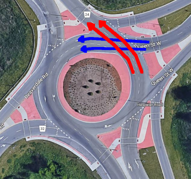

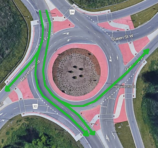

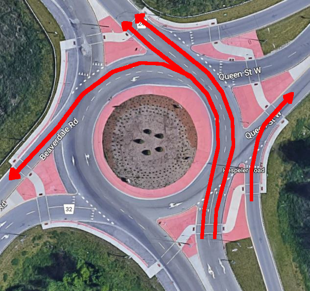

Here is every legal movement within this roundabout. Note that none of them ever cross a lane marking once they are within the circle. You simply enter in the correct lane, and it will spiral you out to your desired exit. In some cases there are two possible exits, because the lane splits at some point.
I personally find it misleading that they use dashed lane markers within roundabouts, even in the places where it is never legal to cross them. I would use solid lines, except in the locations where entering traffic crosses the lane.

The general rule that I have learned (the hard way) is that one should never enter a 2-lane roundabout in parallel to another vehicle, because there are too many places where the vehicle in the center has the right to cut across the outside lane to reach an exit, without even checking their blind spot.
The car in the centre lane never has the right to cut across any lane. They exit wherever their lane leads them to. As you can see in the diagrams above, every lane spirals out on its own. It is perfectly fine to enter a roundabout simultaneously with another vehicle as long as you yield to traffic in all lanes within the circle before doing so. If either of the blue cars below crash into a red car, then the blue car has failed to yield to traffic in the circle.

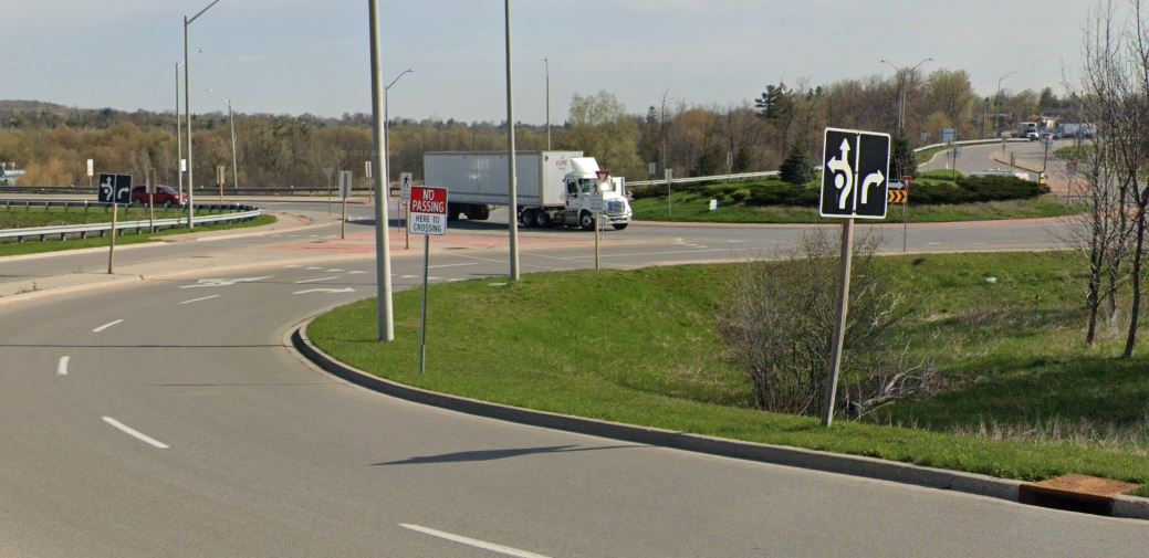

The painted arrows on approach to this roundabout do give some clues, but at the last minute....and this roundabout isn't even symmetrical, so those instructions are direction-and lane-specific. There may be regulatory signs, but the congitive task for drivers to analyse those plus the painted arrows plus lane markings, at speed or in bad weather, is error-friendly.
Painted arrows are not "clues", they are a reinforcement to the regulatory signs. The process of picking a lane prior to an intersection is exactly the same whether it's a roundabout or a traffic signal. If your lane turns into a right turn lane, but you don't want to turn right, you need to leave that lane!

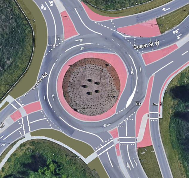

See my green arrow, for instance - is the exit a right signal or no signal? How do I go from Hespeler Rd northbound to Beaverdale without changing lanes in the roundabout ?
I agree that this design makes the theoretical requirement to signal counterntuitive, because the exit radius is basically infinite, making it look like a straight through movement. In addition, that design is extremely dangerous for pedestrians because it encourages traffic to accelerate before having reached the crosswalk across the exit lanes.
Here is a quick sketch where I tightened up the exit radii to clarify what is a "turn" (exiting the roundabout) versus "straight" (staying in the circle):

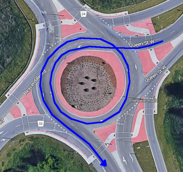

That leads to the other design principle that I have misunderstood - which is, my belief that if you miss your turn it’s ok to keep circling and try again. The turbo feature means, if you miss your lane to exit, you need to take the only legal route out of the roundabout and find a place to turn around.
Correct. One side-effect of the turbo design is that it is not possible to recirculate indefinitely like at a single-lane roundabout or an old-fashioned multilane roundabout. Here is the longest turn I could find at this roundabout:
