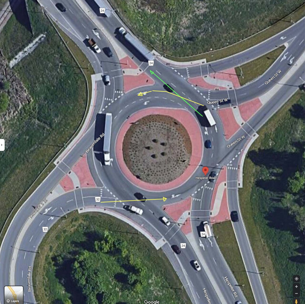

I'm not even sure that the engineering and design standards are sufficiently consistent to be able to train drivers, because no two roundabouts are identical and there are permutations and combinations that are hard to predict. Adding the requirement to signal to that is a brain teaser.
Here's an example - Hespeler Road in Cambridge.
The general rule that I have learned (the hard way) is that one should never enter a 2-lane roundabout in parallel to another vehicle, because there are too many places where the vehicle in the center has the right to cut across the outside lane to reach an exit, without even checking their blind spot.
The painted arrows on approach to this roundabout do give some clues, but at the last minute....and this roundabout isn't even symmetrical, so those instructions are direction-and lane-specific. There may be regulatory signs, but the congitive task for drivers to analyse those plus the painted arrows plus lane markings, at speed or in bad weather, is error-friendly.
I think we should be more cautious about using 2 lane roundabouts, and try to learn from best practice. Turbo-roundabouts have been used pretty widely in Europe and have some design features that make them safer and less ambiguous. The main downside is snowclearing, as there is a raised ridge between lanes to discourage lane changes within the roundabout.

That’s where I was going with my Hespeler Road example. The layout is not consistent with these rules, nor is it consistent with the rule of “never change lanes in a roundabout”. See my green arrow, for instance - is the exit a right signal or no signal? How do I go from Hespeler Rd northbound to Beaverdale without changing lanes in the roundabout ? How do the slip lanes align to the “if in the right lane, always turn right at the first exit“ premise ?
From Hespeler northbound: The right lane goes through the roundabout and onto Hespeler, hence the straight arrow. The lane markings guide you to the Hespeler exit. You cannot/should not use it to get to Beaverdale as that would be a lane change within the roundabout.
The left lane is for straight through (Hespeler)/left turn (Beaverdale). It becomes the right lane after the Hespeler exit. No lane change required.
The slip lanes technically is part of the roundabout setup and takes roles of the "right lanes".
The center lane (ie the through route to continue north on Hespeller) ceasing to be the center route is the puzzle. And, while one isn’t supposed to change lanes, the centre lane splits and necessitates a choice in order to stay in the centre lane (not a frequently used choice, I imagine, but counterintuitive to the “vanilla” two lane roundabout train of thought).
It’s very clever flow-wise, but KISS it isn’t, and if we are trying to train people to follow a basic set of roundabout rules, this doesn’t fit that approach. Roundabouts should not be complicated, even if it traffic flows may suggest logical adaptations.
On closer look, it looks to be a variant of a turbo roundabout, so probably not quite vanilla.
The centre lane (the lane closest to the roundabout centre?) splits, but there is no need to switch over to the new centre lane unless someone is trying to do a 270 degrees turn back to Queen.
