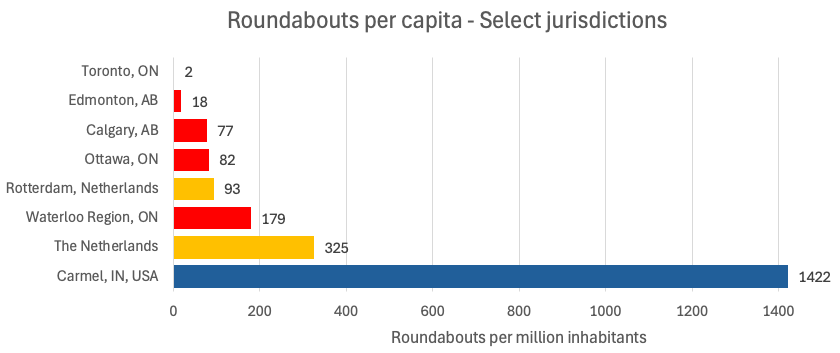

Here's a comparison of the per-capita roundabout prevalence in a selection of areas:
Waterloo Region's number of roundabouts per capita is closer to the Netherlands' than it is to Toronto's. But Waterloo actually uses roundabouts in places where the Netherlands would use a traffic signal, namely large intersections with lots of traffic and pedestrians crossing at-grade. The Netherlands has far more single-lane roundabouts, often in rural areas. There are surprisingly few roundabouts in rural areas in Waterloo Region considering how much safer they are in that context and how much experience the Region has with building roundabouts.
