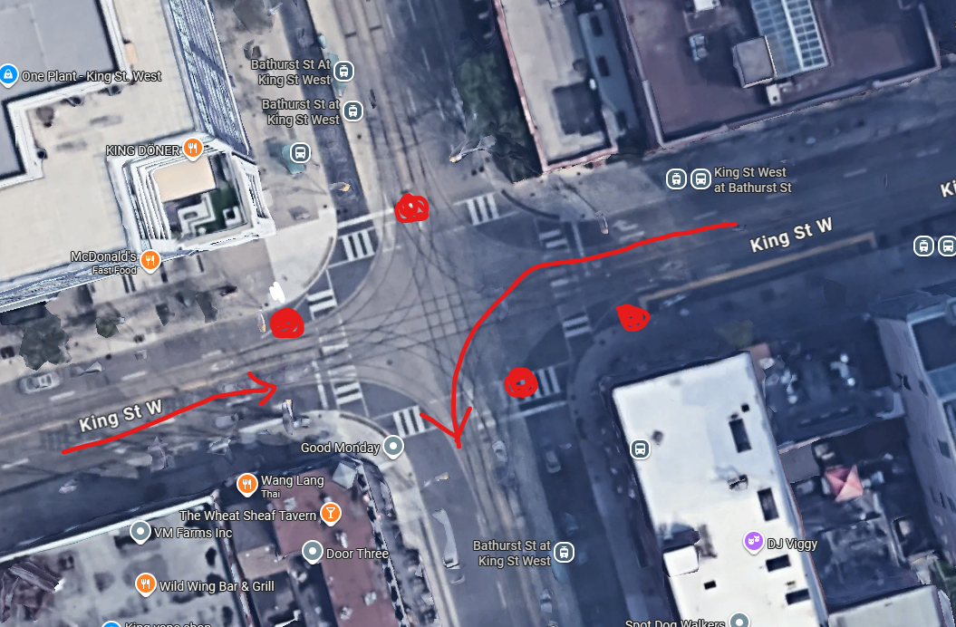

If the signal controller can detect switch positions, this would be possible in the same phase:

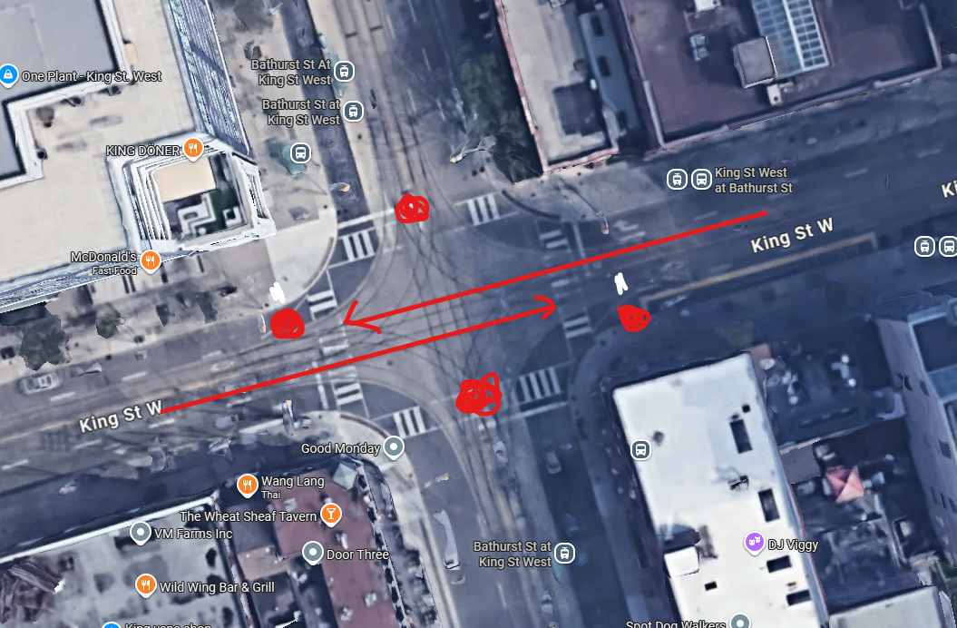

This would then also be possible:

You can't allow eastbound streetcars and westbound streetcars to proceed at the same time if they are both shown a white bar and there is a possibility of one of them turning left (or a bus turning left). The whole point of the white bar is to give priority to the direction seeing the transit bar
Furthermore your proposal would massively increase delay for streetcars since they would need to wait for the pedestrian countdown to finish to clear all pedestrians out of the intersection before they can receive their white bar.
I think he was suggesting that the controller would somehow be able to detect the switch position, then treat the white bar as either a thru-only signal, a left-only signal, or a right-only signal depending on the position. However, can signal controllers really do that?
Here's another issue, though. Are left turns supposed to be fully protected, or are they permissive? It seems like turning streetcars are supposed to yield to oncoming traffic when the right arrow for vehicles is lit, and pedestrians when the pedestrian signal is lit. And in that case, a white bar wouldn't work.
With your proposal, I take it that the white bar would shut off when the left turning streetcar approaches?
Yes the signal controllers can detect switch position if you connect them to the switch controller. For example the transit bars north-south on Spadina are called by the switch controller detecting a streetcar that wants to turn off of Spadina.
However, connecting the switch controller to the signal controller includes some fairly expensive wiring so you'd only do that where there's actually a significant benefit to transit performance.
You also can't depend on the switch controller to manage conflicts because buses exist and they don't request switch positions.
