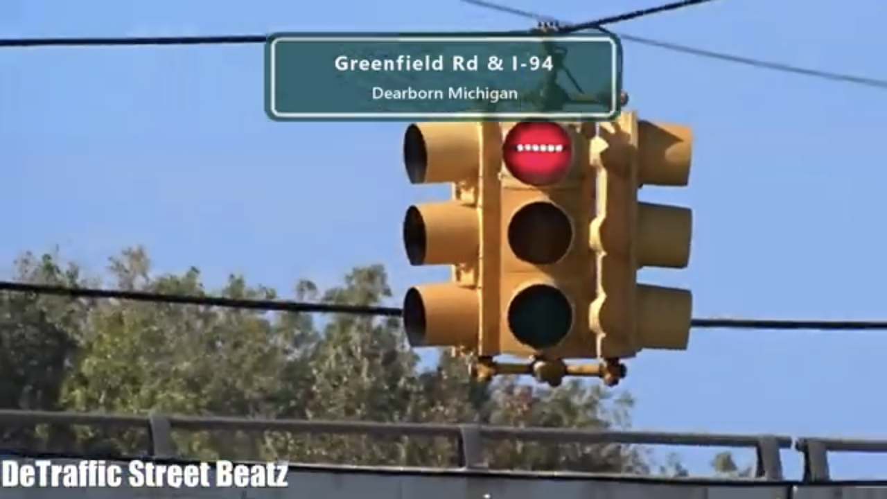

There are actually places in North America that do this.
I recently learned from @reaperexpress that Portland experimented with several different styles of indication lights. They even have Dutch ring-shaped countdowns.
