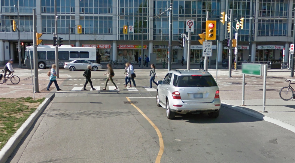

Wouldn't it be better if we replace this sign
with a nearside traffic signal?
Right where the motor vehicles should actually be stopping?
[STOP HERE ON RED]
We already do that for signals where the stopping location is unusually far back.
Harbourfront Centre at Queens Quay northbound. Image from Streetview
Queen at Wineva westbound. Image from Streetview
In locations such as the Netherlands where signals are only on the near side, they are extremely effective at enforcing correct stopping locations. But in locations where they are used in addition to far-side signals, they are only marginally effective. If we were starting from scratch, I'd probably support near-side signals but at this point it's not worth switching.

The near-side signals would be a good addition, especially on large or busy intersections. The far-side signals sometimes gets blocked by high trucks blocking the view.
The near side signals you normally see are to provide an extra signal in areas where visibility of the far side signals is reduced - typically at hills, turns that lead to intersections, etc.
