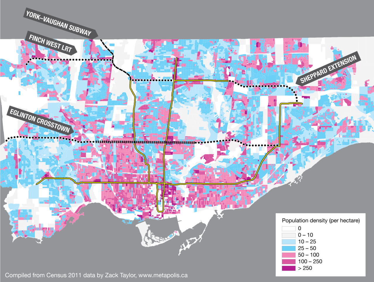

Regarding the tax burden placed on Scarborough residents and the idea that subways would have been built in Scarborough already, are you familiar with this chart:

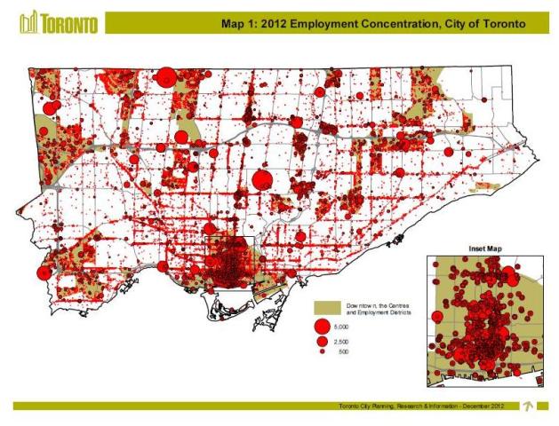

Or this chart:
For the life of me, I cannot fathom how the SSE or an extension of the Sheppard subway will deliver the density needed to justify the investment. If Scarborough were an independent city and the lines had been built the result would be a tremendous tax burden on Scarborough residents.

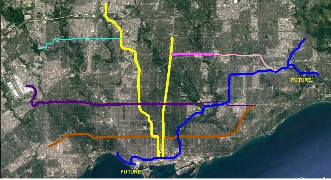

What Scarborough really wanted was a continuous grade-separated reliable rapid transit line connecting to downtown. (see map).
Fastest way to downtown from many areas of Scarborough would have been this line cutting diagonally through Scarborough. (would have helped East York and Liberty Village too).
Sheppard line would be extended to Downsview (and interlined). That way, an LRT trip could be made on Sheppard to:
  1. The new Scarborough line
  2. The DRL Long
  3. The Sheppard line to York U.
