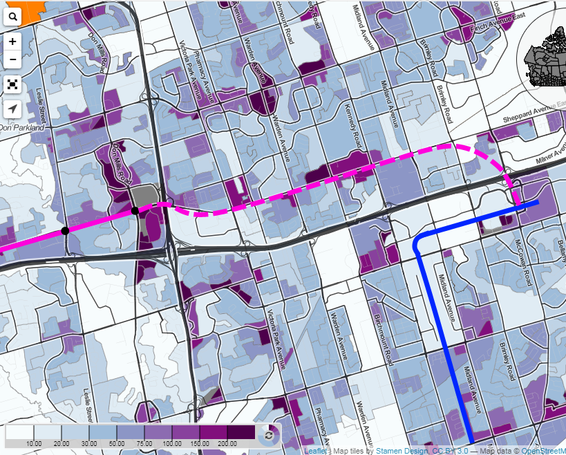

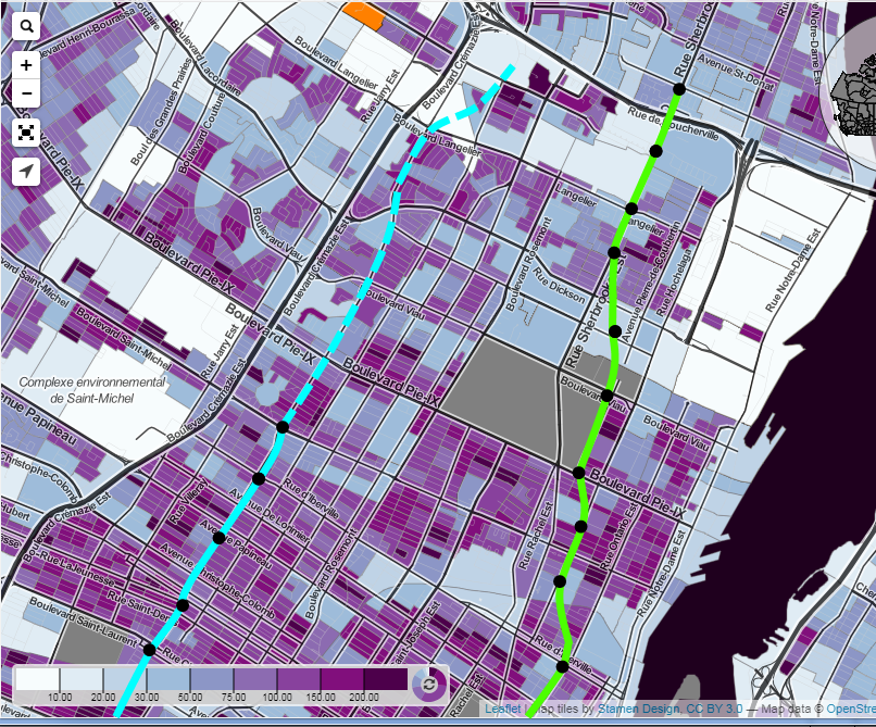

You've given a few examples of intersections... Toronto tends to have tiny pockets of very high density surrounded by oceans of low-density single family housing. Montreal has fewer high rises, but makes up for it with lots of midrise apartments, triplexes, etc.
This is what the population density looks like for the Sheppard line extension (courtesy of the 2016 census mapper)
And this is what it looks like in Montreal:
