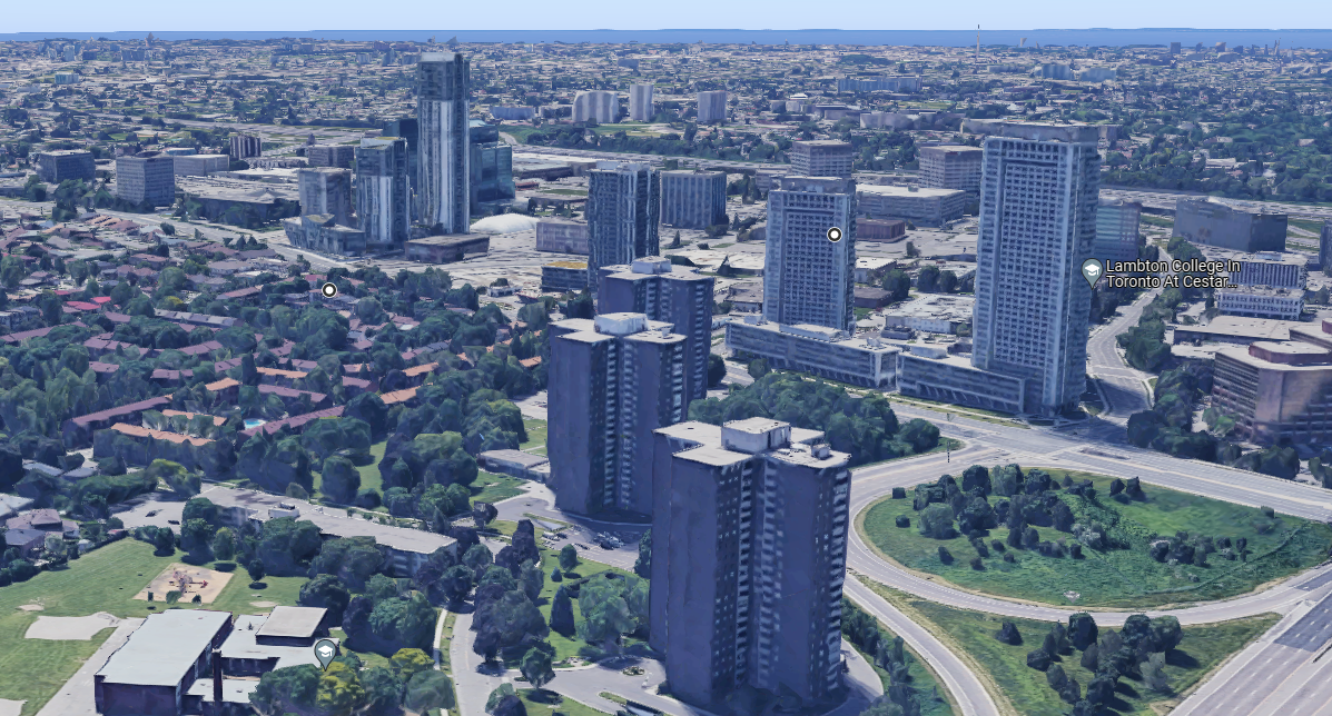

Heavy metro favours fewer stops and wider spacing, but this necessarily means serving some spots at the expense of others. For example, do you place a stop at Consumers because it's a big employment area, or Vic Park because it's a major crossroads? Similarly, do you place the stop at Kennedy or Agincourt GO? It's a long walk for the other.
Why not both in those cases?
Sheppard's low density and the spacing of major roads makes it really awkward to serve with heavy metro. At least with the LRT plan, it was trivial to locally serve all these locations.
Actually its the opposite. With low density areas, people want and need to travel much farther distances. As such - this makes LRT extremely unattractive as a mode because it ends up being way too slow for what most people need, and if the mode is way too slow, more people will be taking the car. Adding extra stops makes this worse as you're spending more time at stations rather than travelling. This is why if we look at systems like Viva, despite being a mode where tight stops are quite possible, they purposefully put stations and stops every km or so - it fits better with what people need from transit in such low density areas.
Both - they are 700m apart and its decently dense near Consumers.
It's only 400m between the two, which is not a long walk. Could do something similar to Kennedy Station, locate the station in between Kennedy and Agincourt GO, with short tunnels either to an entrance fronting Kennedy or to the GO platforms (depending on where it is located specifically).
