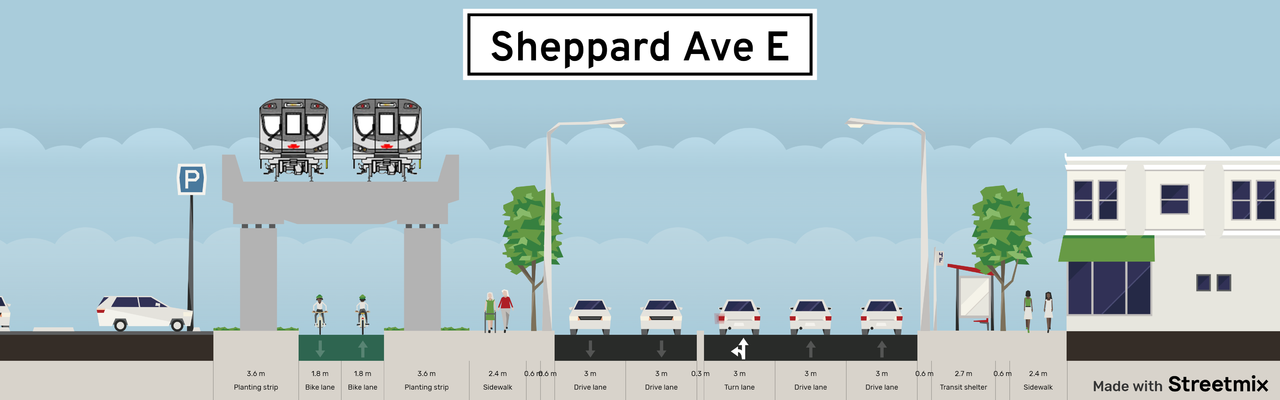

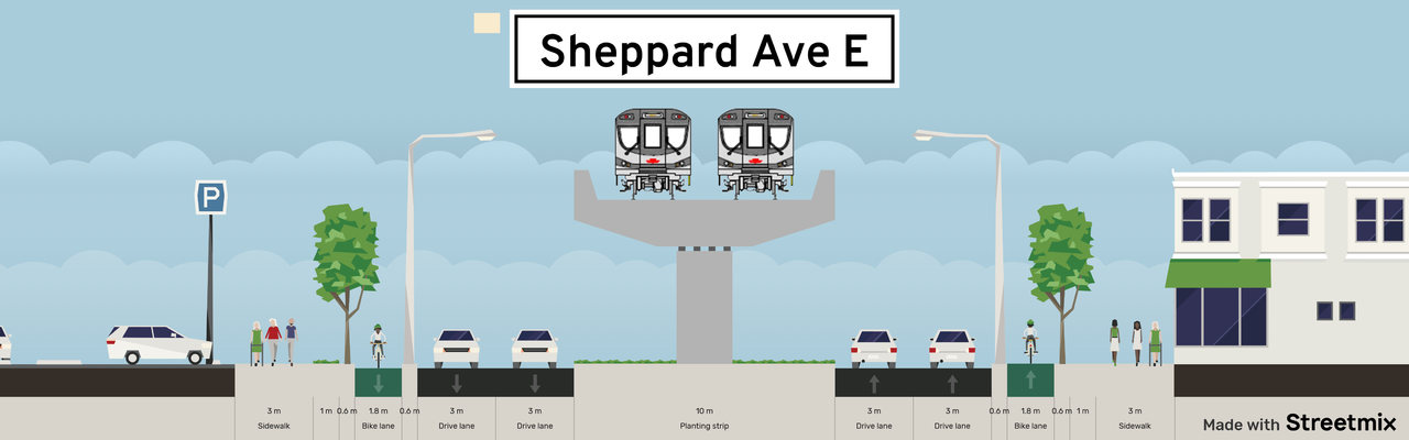

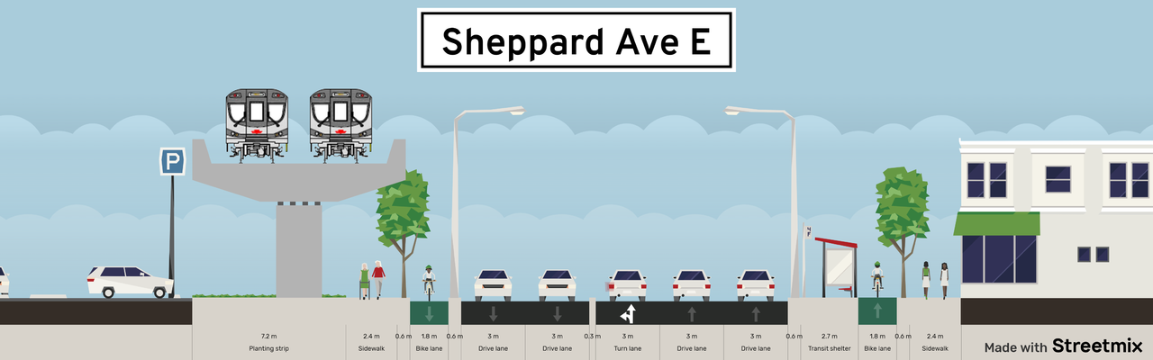

made a quick visualization of what this extension could look like elevated

Keeping with the same technology and rolling stock is more than doable for an elevated extension. These all stay within Sheppard's 36m right of way, but there is also ample room adjacent to the right of way in the form of parking lots, driveways, grass, or low-density commercial buildings for large sections. The width of the viaduct is based on the few bridges the subway currently operates on (ranging from 10-11m wide). It is only around 1m wider than the narrowest of Vancouver Skytrain viaducts, (9m on the Canada Line), with most Skytrain viaducts being the same size as Toronto's. While light metro may reduce some construction costs in some areas, the costs of converting the rest of the line and building a new MSF are probably higher. Given that the "proposed" alignment is a straight line, light metro doesn't really offer much in terms of maneuverability compared to the TRs. I don't see converting the line to light metro as making an elevated extension any more feasible. Really the only substantial barriers I see to an elevated alignment are politicians and residents of the area.
yeah, no political party is going to present an elevated guideway for 3.2m wide trains running down Sheppard. That's pretty much a given. And what are the peak projections for a Sheppard extension. Like 8k pphpd? Meanwhile a 6-car subway is designed for 36k. You're saying building a line with 400% more capacity than is needed results in "some" construction cost differences? Would be a lot more than some.
