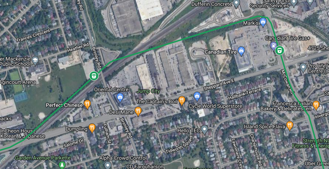

so something like this could be possible in the future theoretically? also creating an easy connection to a hypothetical future Midtown Line Line station west of Brimley?
The curve should be smoother; TTC recommends a 300-m turning radius to reduce the wear of the wheels and rails. But I think it is doable.
I see 2 advantages and 1 disadvantage of combining Lines 2 and 4.
One advantage: all connecting routes terminating at Sheppard / McCowan and at STC will be connected to both subway lines. The same can't be achieved if the 2 lines stay separate.
Another potential advantage, only applies if they want to build a new subway yard in Malvern next to the CP yard. Then the connection between 2 and 4 brings the tracks closer.
One disadvantage: the combined line will be longer and thus less stable operationally. Say, when Line 1 has a delay somewhere between Finch West and York U stations, that delay is felt on the Yonge branch. The Operations Control tries to mitigate the impact and short-turns some or all trains to restore the headways in the unaffected segments, but the initial effect is always present. The same will be happening on Line 2+4.
