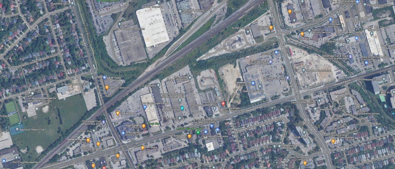

i'm no engineer, but couldn't it still loop around to connect to a Line 4 east extension despite it's awkward placement if there's enough desire to make that connection happen. the one seat trip was a big selling point to getting this Scarborough Subway Extension built in the first place wasn't it? not having to transfer at Kennedy. it might also create a better connection/transfer to Agincourt GO station too.

The next "station" west of McCowan Road would likely be Brimley Road. Having Line 4/2 curve north would be possible.
From link.

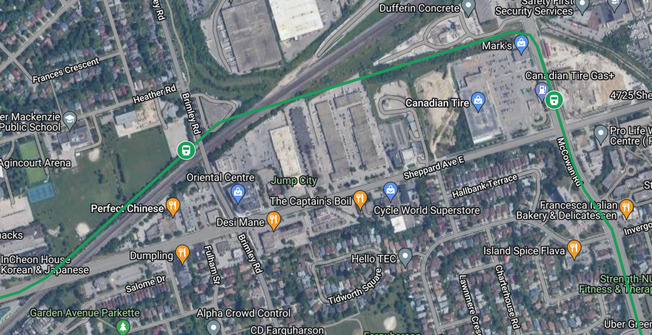

so something like this could be possible in the future theoretically? also creating an easy connection to a hypothetical future Midtown Line Line station west of Brimley?

sure, but what about a connection to a Midtown Line in the future?

Absolutely. The "loop" is a creative bit of imagination given today's built form..... but both lines will need to push farther east and north down the road. Joining the lines impedes that growth.
