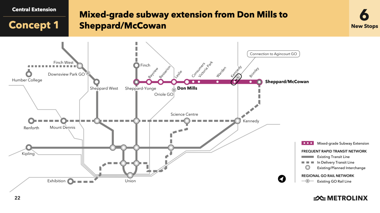

The thin line is the existing Sheppard subway.
It will not be above ground in the west end at all. * (except, maybe when crossing the valley)
Nor would it be above ground west of Victoria Park in any scenario.

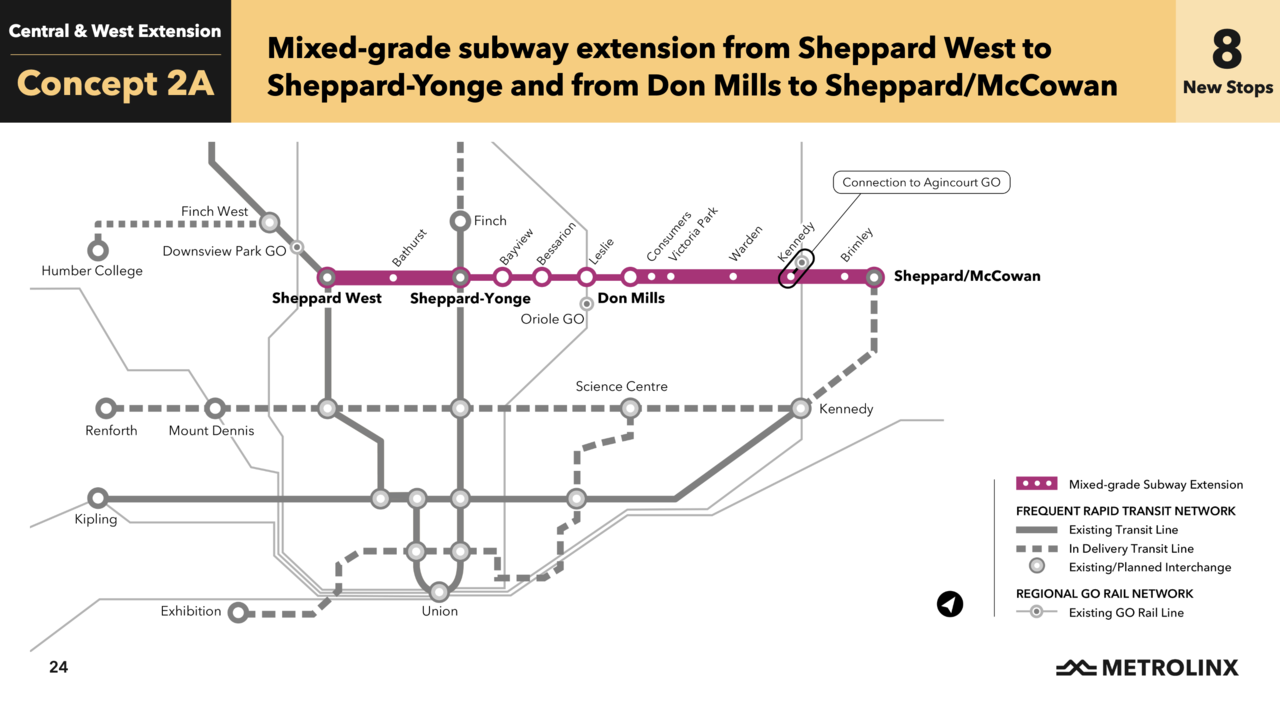

One could debate......under options 2A, and 3 where elevated grade may begin, or may not.........
Option 2B would almost certainly be above grade where it would follow the existing SRT ROW, and on to Centennial College as there is no case for it being underground at that point. East there of......could involve some very animated conversation.

Consultation docs are up here. They are proposing a mixed-grade subway (underground and elevated) and four route options. Some highlights below.
Elevated... Subway? Not a massive single bore tunnel with 4 story deep stations?
... Wait, this does not compute.
Is... is the Ontario government building this... in a reasonable manner?
I... I can't believe this... I...
faints
