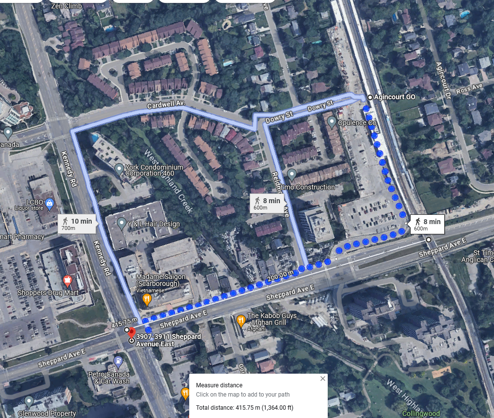

Also the other question this whole document raises is where exactly are they putting the station at Kennedy?
Kennedy to Agincourt GO is 300m, meanwhile a full length subway platform is 150m. I really hope they don't just plop the station east of Kennedy, and require people to walk 150m to reach Agincourt.
A station at Agincourt meanwhile would allow for far better transfers, and I don't think diverting the Kennedy busses 300m east to reach it would be the end of the world. The only big issue I see is no direct subway connection to Agincourt Mall, but I think a direct connection to the Stouffville Line should be a higher priority.
Couldn't they extend the GO station and platforms closer to the bridge? Then it is just a matter of going up.
No, because the walk from Kennedy and Sheppard to the rail corridor alone is 415 m.
Have the west end of the subway platform end directly under the intersection. Have the portals for the west end come up at the corner. Have the east end come up at the end of the GO platform. So,with the platform and the walkway, it should not be too bad of a walk.
