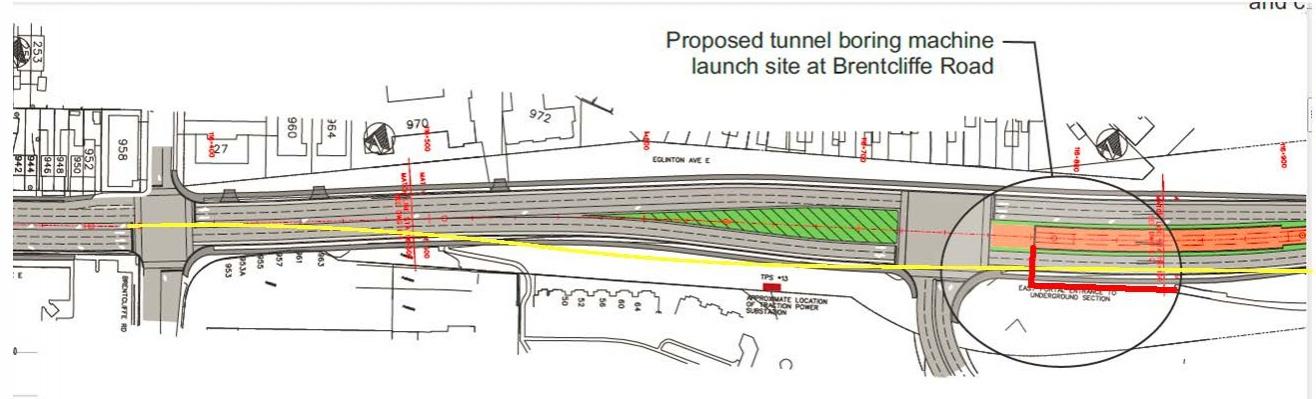

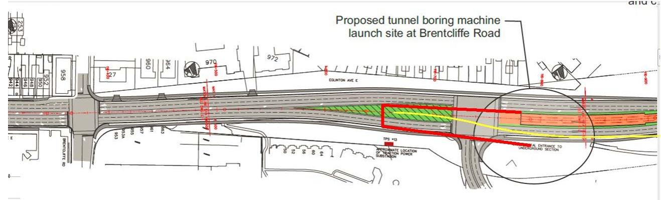

I can't remember if someone already posted this, but I drove by the eastern (Brentcliffe) launch site and they've narrowed the road to two lanes, with lots of equipment.
So it looks like major work on the eastern launch shaft has started (or will soon).
  1. The best plan here was to move the portal to the side of the road and maintain 4 lanes of traffic during construction.
  2. Now that it is down to 2 lanes, it looks like this option is off the table. I imagine the launch shaft and headwall can still be moved south to allow for tunnelling to occur from the south side.
  3. If they miss this opportunity, they will have to start tunnelling from this median location, but choose a different alignment (I believe they can handle 300m radius curves) for the tunnels to get to the "proper" alignment as soon as possible. Then it would require about 100m of the tunnel to be excavated and discarded and rebuilt with cut-and-cover at the south side location, possibly tighter than desirable curves (300m) to be built.
  4. If the tunnelling has already started on this original alignment, then it would require about 120m of the tunnel to be excavated and discarded and rebuilt with cut-and-cover at the south side location, but with possibly tighter radius curves (300m) to minimize the amount of cut-and-cover required.
The real question is at what point will someone realize that there is $1B to be saved by connecting the SRT to the Eglinton line, instead of building Eglinton as an on-street LRT and serving STC by subway. Also, when will people realize that the fate of the DRL is most likely tied to Eglinton being a grade-separated line (without this, Metrolinx will use GO to relieve Y-B and not the DRL).
For this portion through Leslie, until they begin work on the Laird Station headwalls, it will undoubtedly makes sense to switch to the south side alignment. This is because the cross-over and pocket tracks could be moved from the middle of Eglinton at Laird to the south side near Don Mills - this construction savings would significant. Of course there will be some wasted money, but that is what happens when you put your head down and start constructing the wrong thing - instead of thinking first before you build.
