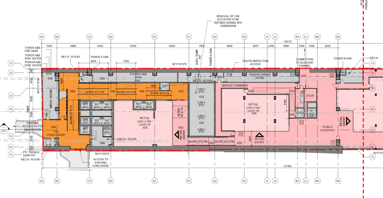

I am hoping that the plans they will be submitting at the SPA stage will rework the ground level so that enough of the servicing can be moved to where the car elevators were planned for, so that they get enough space to take the taller tower elevators all the way to ground level. Doing that would make life much easier for anyone living in this building… otherwise the place would become known over time for how horrible it is to live there.
Here's the current ground floor layout:
Here's the current 6th floor (transfer level) layout:
You can see that the taller tower elevators are positioned in the second most easterly section between supporting columns, and if you look to the other image above, you'll see that area is currently servicing, but that servicing will have extra space in can move into to the west once the car elevators are removed from the plan.

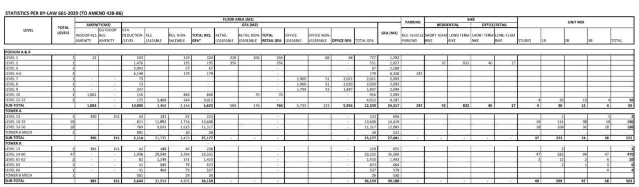

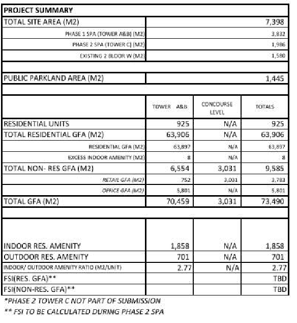

The total unit in Tower A & B changed from 1090 units and. reduced to 925 units. No new renderings are updated in the database.
Might need to change your wording, Art: it was 925 + 725, then increased to 1090 + 725...it wouldn't make sense that the total unit count is now 1090 here (a lost of 725 units).
Lets see what the Plan says:
Is the discrepancy here about TOWER C? Which is not part of the above submission?
Edit to add: Yes, that's the 725 units that went missing, they are Tower C!
