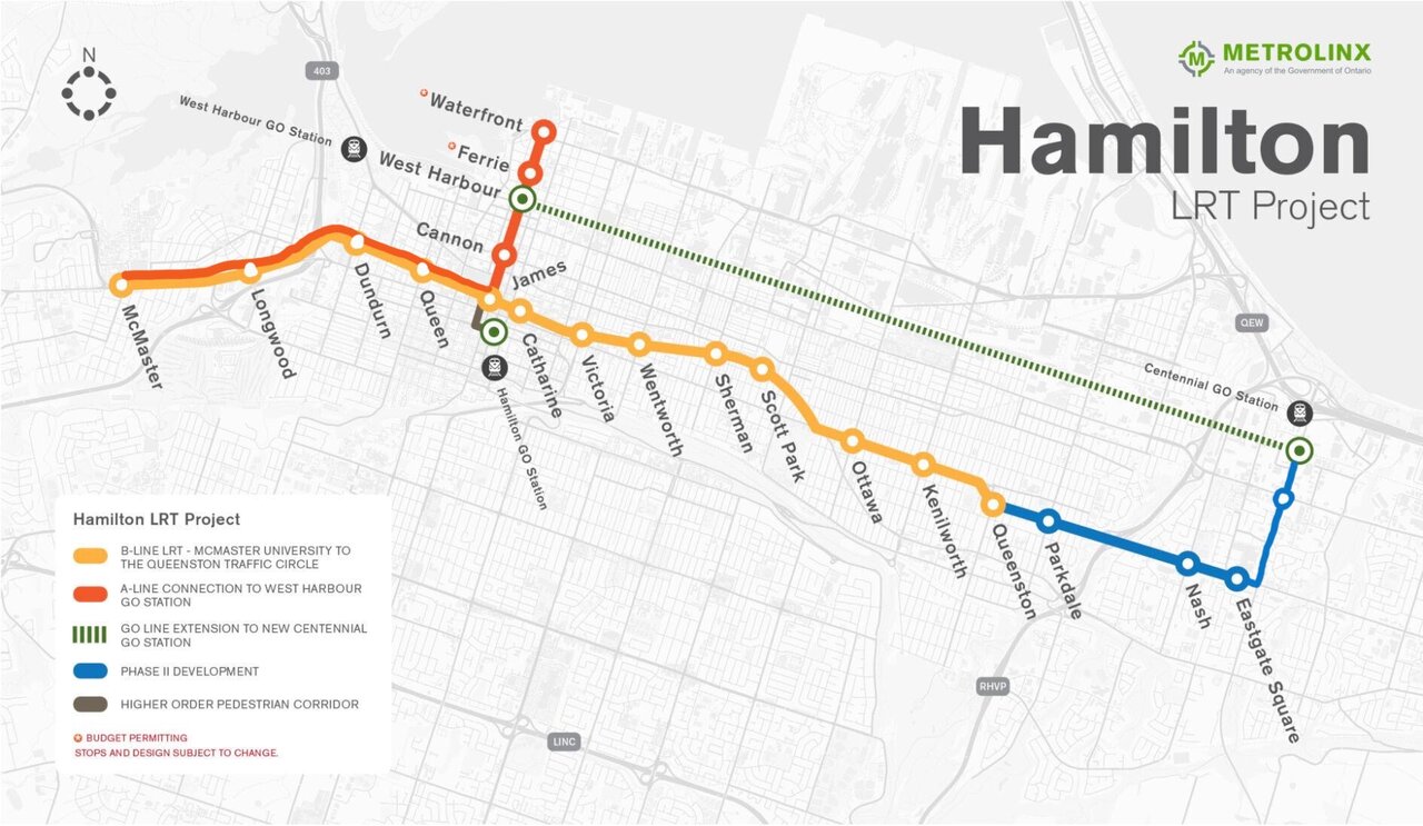

I always liked formerly proposed waterfront spur, it’s a shame it got cut. Both great for GO connectivity and developing the waterfront. I’d go a step further and interline the waterfront spur with the mainline to McMaster, which connects to a major trip generator and adds frequency to the downtown.
As a future project, I’d also connect the line up with Confederation GO. Eastgate Mall has a huge redevelopment proposal, and a short 700 metre-ish link to regional rail would be hugely beneficial.
Back-of-napkin proposal below:
Small extensions make a lot of sense for Hamilton imo. The James spur made/makes a lot of sense given the importance of the corridor and cements it as LRT—at least in the lower city— instead of BRT.
I actually think there’s a lot of places where small extensions/spurs could be introduced, lending the LRT to becoming a trunk line. By comparison with KW-C/iON, Hamilton’s travel demand doesnt taper off nearly as quickly from their respective King Street’s given the city’s morphology. With more city control over the LRT’s ops and expansion, we’d likely prefer service flexibility akin to the TTC’s streetcars, and favour piecemeal growth. This would be pragmatic and precise for a cash-strapped Hammer, especially given the intimate knowledge of travel demand the HSR has.
That’s opposed to Metrolinx, who will wait on entire corridors to be transit ready. Full RT BL(E)AST is decades off, but branches to Dundas, Centre mall, Confederation, Meadowlands, and a phased A-line to Limeridge, etc. is much more actionable. It can be less track-kms than a single new line, but hit more of BLAST’s key nodes than any single line would. It also allows for the fabled “continuous work” expansion model.
Aside from initially helping sort/fund this arrangement with the city, Metrolinx can come in and help us out again (in their typical style) when we need a line to climb the escarpment. Save future once-a-generation funding for projects of corresponding scope, like this project itself.

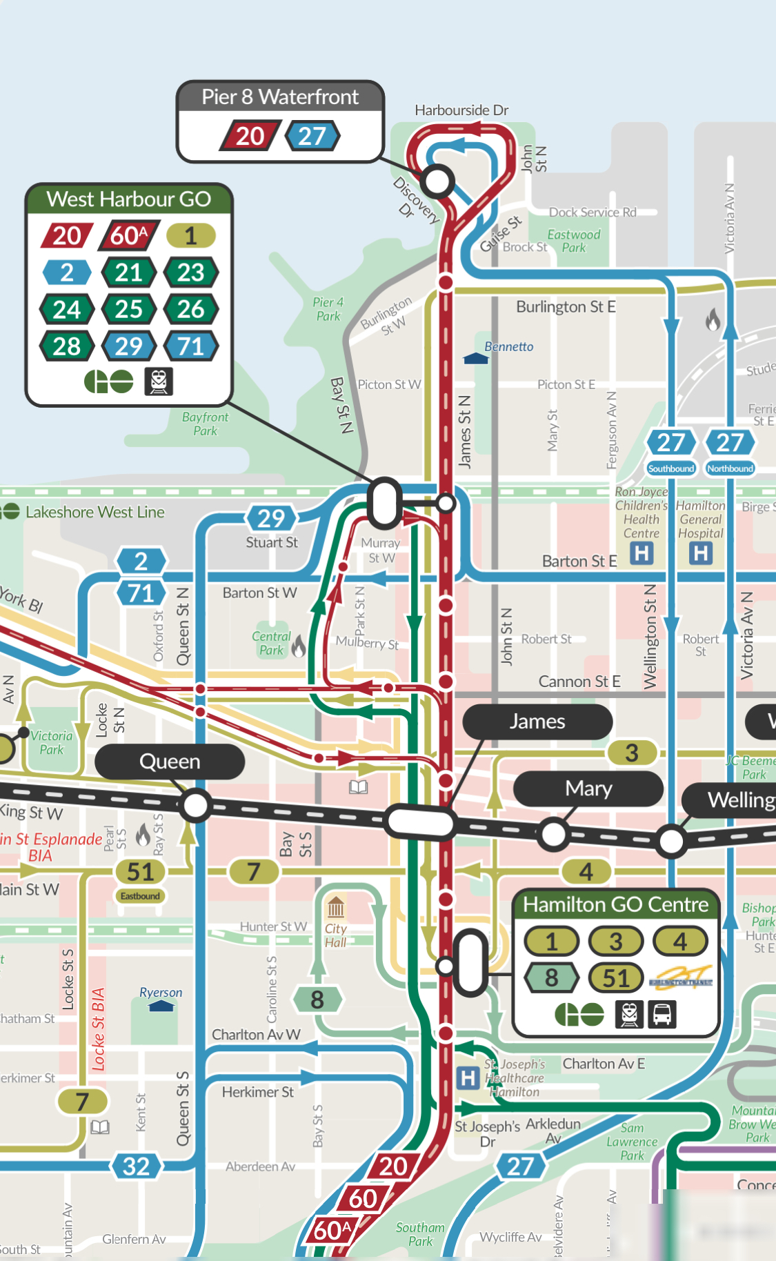

I will say the lack of a super short connection to West Harbour is very annoying - with service getting better and better it sucks that getting that done is going to require a whole process and probably (as ridiculous as it is) several years of additional waiting
HSR just made the 20 A-Line a 7-day-per-week route, with increased frequency during day times. This connects West Harbour to the 10 B-Line and Hamilton GO Centre.
The 2 Barton and 4 Bayfront also travel along James between West Harbour - B-Line - Hamilton GO Centre.
So there are a few good short connections at West Harbour today, with even more coming whenever the City gets its new bus barn built!
(https://www.hamilton.ca/home-neighbourhood/hsr/riding-hsr/reenvision-hsr)
The City/ HSR should also extend the current 34 Upper Paradise down Queen to West Harbour like tomorrow! A new M&SF wouldn’t even be required!

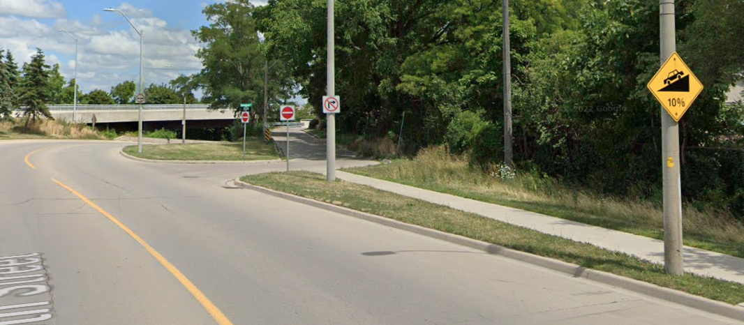

Anyone know whether a light rail vehicle could climb 10% gradient that's about 650m long?
Wikipedia states that the maximum gradient for friction-based rail is 10% after that a rack-cog system is needed: https://en.wikipedia.org/wiki/Rack_railway
Yes they can if the right car is used. This has been raised a number of time on the another board that I am on for professional transit planers, especially related to stops on grades.
