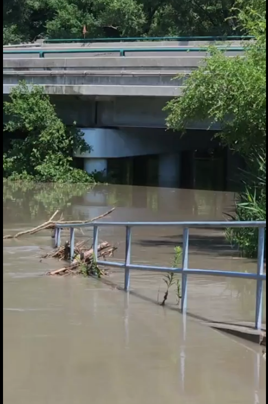

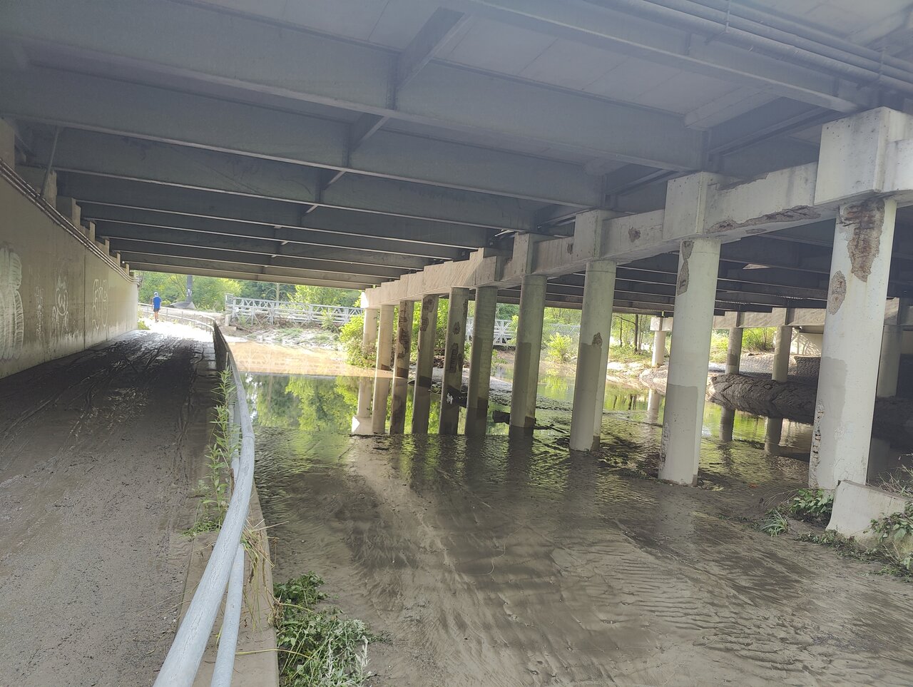

So based on the above, the Don is ~3.3M or just a bit over 10ft above normal height.
That would correspond with an image from the Beauty of the Don FB group by Stephen J. Shpak from which I plucked this still of Taylor Creek below the Don Valley Parkway bridge. Note that there is normally a bike path under that bridge....
I ran through there at about 6:00 pm and the path was covered in mud, but passable.
